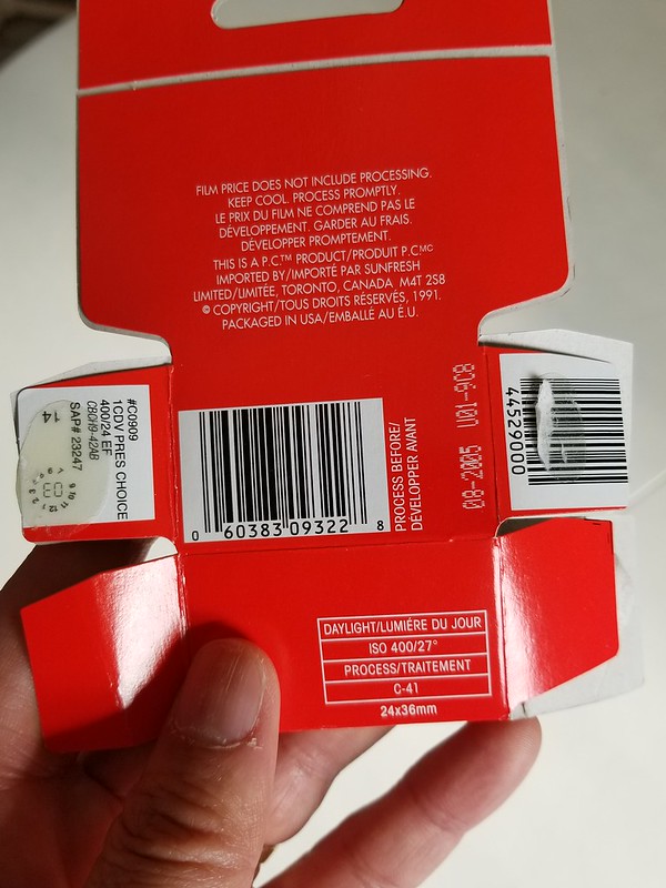

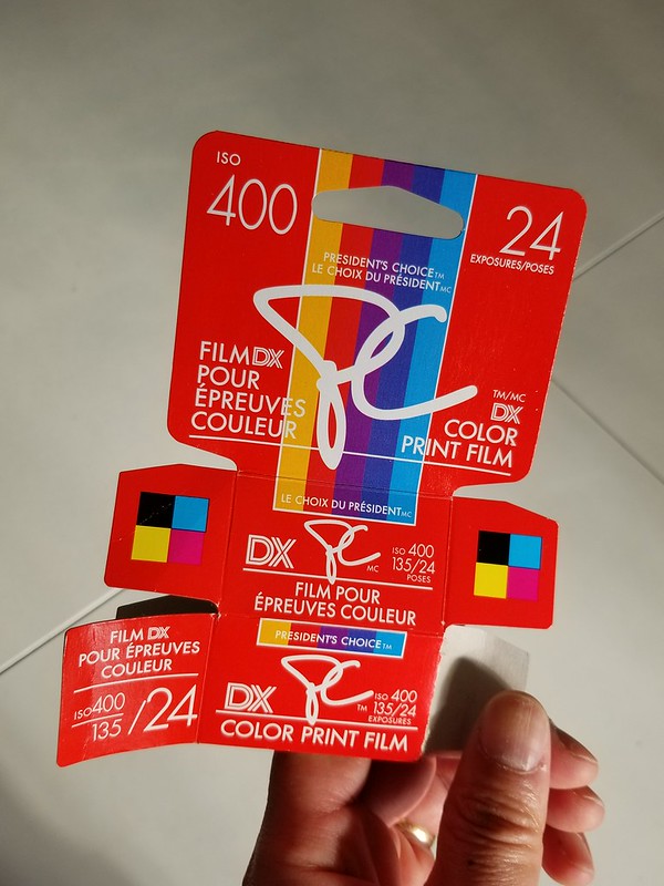

A family member unearthed some PC Colour Print Film, ISO 400. Expiry date of Aug 2005. Sitting in a cupboard all these years.
How should this be exposed? I heard I should over-expose by 1 stop for every 10 years beyond expiration date. So overexpose by 1.5 stops?
What could happen to the colours? I heard the colours go funky after expiry.
And does anyone know what brand or manufacturer was behind President's Choice 400 film back in the day? Just curious.
