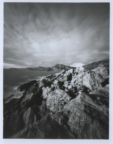

low res scan of a contact
f/176

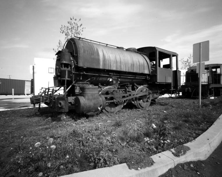

Here's a 4x5 negative scan:
A 0.305 mm pinhole @ 63 mm from the film plane, a relatively wide angle of view.
Arista ULTRA 100 exposed 8 sec with the f/210 pinhole.
The camera was a relatively fancy project using plywood.

Thanks for posting that up, that's a nice image made from a nice looking camera, it almost looks like a large format field camera in its collapsed form, how did you make your pinhole?
