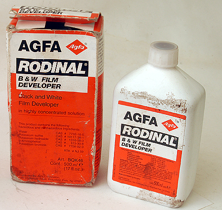

I bought these two plastic 500ML bottles at an estate sale here in LA for cheap. Both seem full. The boxed one has an old price tag of $6.95. Both bottles have the number 86129Y stamped on them. I see no dates. Can anyone give me an idea of their age?
At least as old as the 90s I'd say, maybe even older than that. The 86 might mean 1986. I believe Agfa changed to clear bottles in the late 90s/early 00s. Don't quote me on that though.

Yes, Rodinal can be fine after many years. But also not when kept in, for instance, very hot temperatures.
AGFA only used production codes, you must have the key to read them (except for film).
AGFA went bankrupt in March 2006. Rodinal was introduced at the end of the 19th century.
Your plastic 500ml bottle must be around 20 years old al least.
Rodinal made during the interbellum still works fine, so don't worry...
ADOX still makes it according the original formula, it's the oldest commercially made developer on the market.
On the instruction sheet does it list Panatomic-X ? That was reportedly discontinued in 1987:
Yes, it lists Panatomic-X.
It also lists TMax films but not Ilford Delta films.
So, I think that would put it at late 80s to early 90s.
Unless it's just an old data sheet included in a newer product. I have seen that before.
