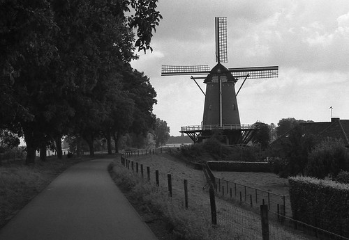

Retro 100 - Rodinal 1+25

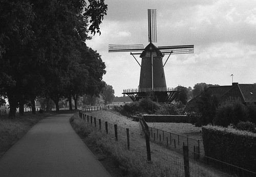

Retro 100 - 4 years old Rodinal 1+25
