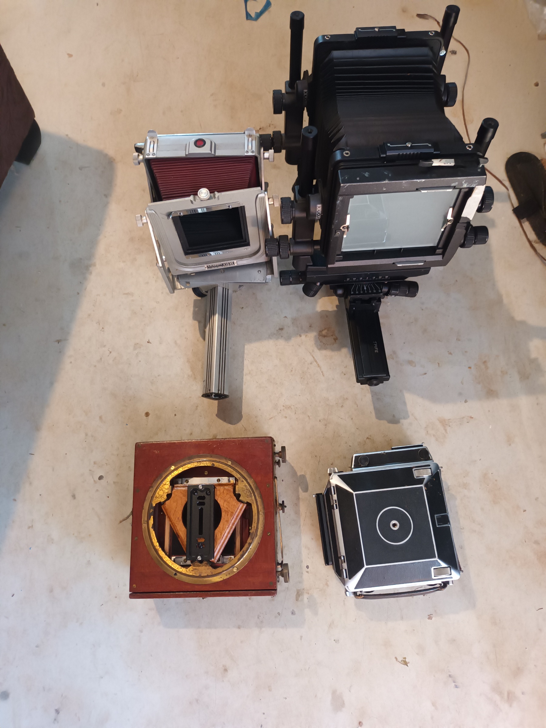

As a coincidence, I just had my Graphic View II out. Weight with the dedicated tripod head and a lensboard, but no lens, is 8lb 4oz/3.7kg.
The Graphic View does compress down pretty small, but bear in mind for packing, the monorail doesn't come off (at least I don't see a way to remove it), so you're stuck with a box with a long rod at the end of it.

I have both a Graphic View and a Graphic View II. They weigh about the same, unsurprisingly since the frames and rail are almost identical (only significant changes to the II were centered movements, Graflok back option, and a different color and slightly different length of bellows). With the tripod adapter mounted on the rail and a 150 mm Componon, the camera weighs around 8 lbs.
Shoot. I thought the standards were detachable from the monorail. 8lbs is too much, too. It seems I want a field camera. And yes, the realization did hit this morning that a Crown Graphic would probably fit the bill. There is no real budget yet, but $1000 with a lens would be a good working guide.

You are right, the Linhof Technica iii press is 2.5kg with lens, but very compact. The Graflex ii view is 3.5kg without lens, but also not very compact. The Cambo legend is 7kgs, big and bulky. My antique Thornton is just under 2kg and folds up to half as big as the Linhof.
