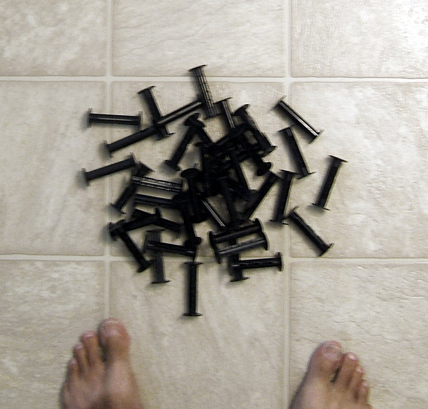

gone
If you don't have a photo store nearby that has spools, I have spools. Just PM me w/ your mailing address and I'll send you a few gratis. No backing paper though, I always threw it away.
Jeez, I hate to think how much money it cost me to get these w/ the film attached (this is just a few of the spools around here). If you shoot medium format, spools are like Tribbles. They seem to multiply on their own.
