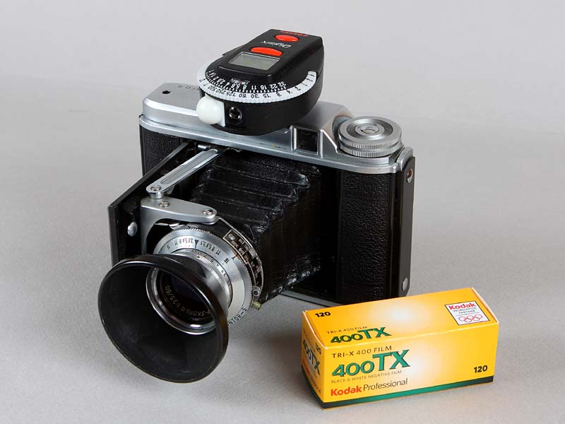

And there's always the "hybrid" approach ...
I don't generally do this, but I own the (rather expensive) accessory shoe adapter for my Digisix.
