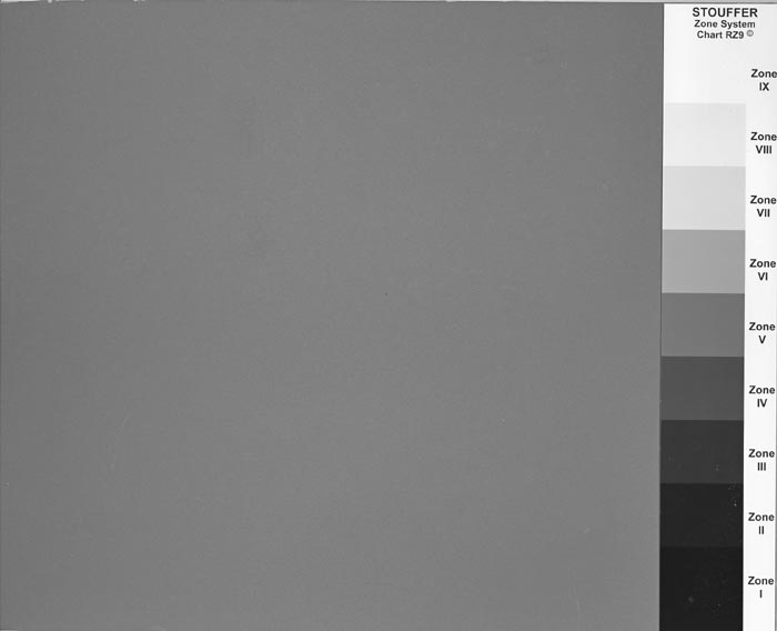

Here's a down and dirty system that I use... First of all, I am a nut job with 3 densitometers and have been back and forth with many trials, mostly out of curiosity and wanting to learn over the years. Still, I normally rely on the following and general experience.
I have mounted a Stouffer RZ9 Zone strip to a Kodak gray card edge. I can quickly see if there is separation at the extreme zones and make some reasonably accurate decisions on exposure/development times, etc from a quick look. I always do this on new films or developer combinations. When I have a spare frame and/or remember to, I include a frame on known materials and equipment to catch if anything is going amiss on metering, solution activity, etc. I can also do subsequent frames up/down in exposure to determine shifts.
I've attached the card/zone combo to illustrate. The large gray card area also gives me a readable area for checking on a densitometer so I find it a usable, consistent reference point. I can also plot projected curves from the smaller step wedge areas if I want to delve further. I find myself doing less of this as experience starts to allow a lot of interpretation from a simple inspection with a loupe on the film.
This also allows for flare effects at the taking point. I believe that flare has much more effect than one would initially expect. I helped resurrect a local school darkroom a few years back and was pleased that the equipment was nice, respectable gear (good enlargers, various heads and 6 element Comp S, Rodagon and Nikkor lenses). Everything appeared in good order and the optics looked nice and clean at quick inspection. We chased our tails, getting bland, low contrast results. Inspection showed a very, very slight haze (almost imperceptible) in the lenses. I brought some optics from home and the difference was dramatic. It was at this point, I became less obsessed with hair-splitting densitometry testing!
