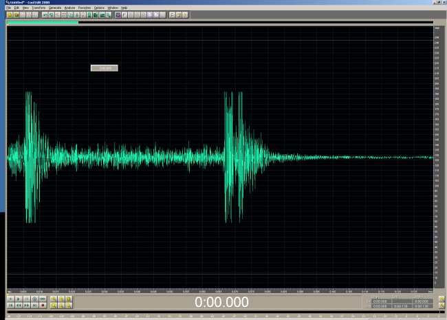

Yup, me too... Attached is a fairly recent Compur 1 at 1/15th (actually measures closer to 1/16th...) using Cool Edit 2000. Depending on the shutter, it can measure up to around 1/125 but this is fine as I rarely shoot faster than 1/15th.
Cheers, Bob.
