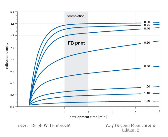

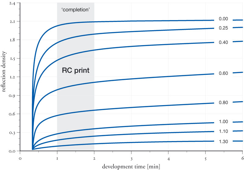

There is no such thing as developing to completion. Development continues until the paper fogs (see attached graphs).
Factorial development is great but works a lot better with FB than it does with RC, because rapid initial development with RC makes it difficult to estimate final development time.

Yes, that's probably what they mean, but it implies that nothing more happens afterwards and that it is safe to leave the print in the developer until the paper fogs, and that is not the case. Once the darkest shadows have reached Dmax, all other tones slowly continue to increase density, which does the image no good. Consequently, there is an optimum development time, at which point development should be stopped. That's how I understood the OP's questions.
