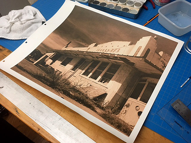

As I and others have said, Lith printing can deliver paper-whites with even badly fogged paper. I have some ektalure that seems about 2 stops fogged - trash, basically - but it's holy-grail paper for lith printing and looks stunning. If you have a big stock of old paper, grab some lith dev and google up the techniques. I only do straight printing when I need a paper mask for a lith print nowadays, and for contact sheets, etc.
16x20 Ektalure lith print:
very nice.
