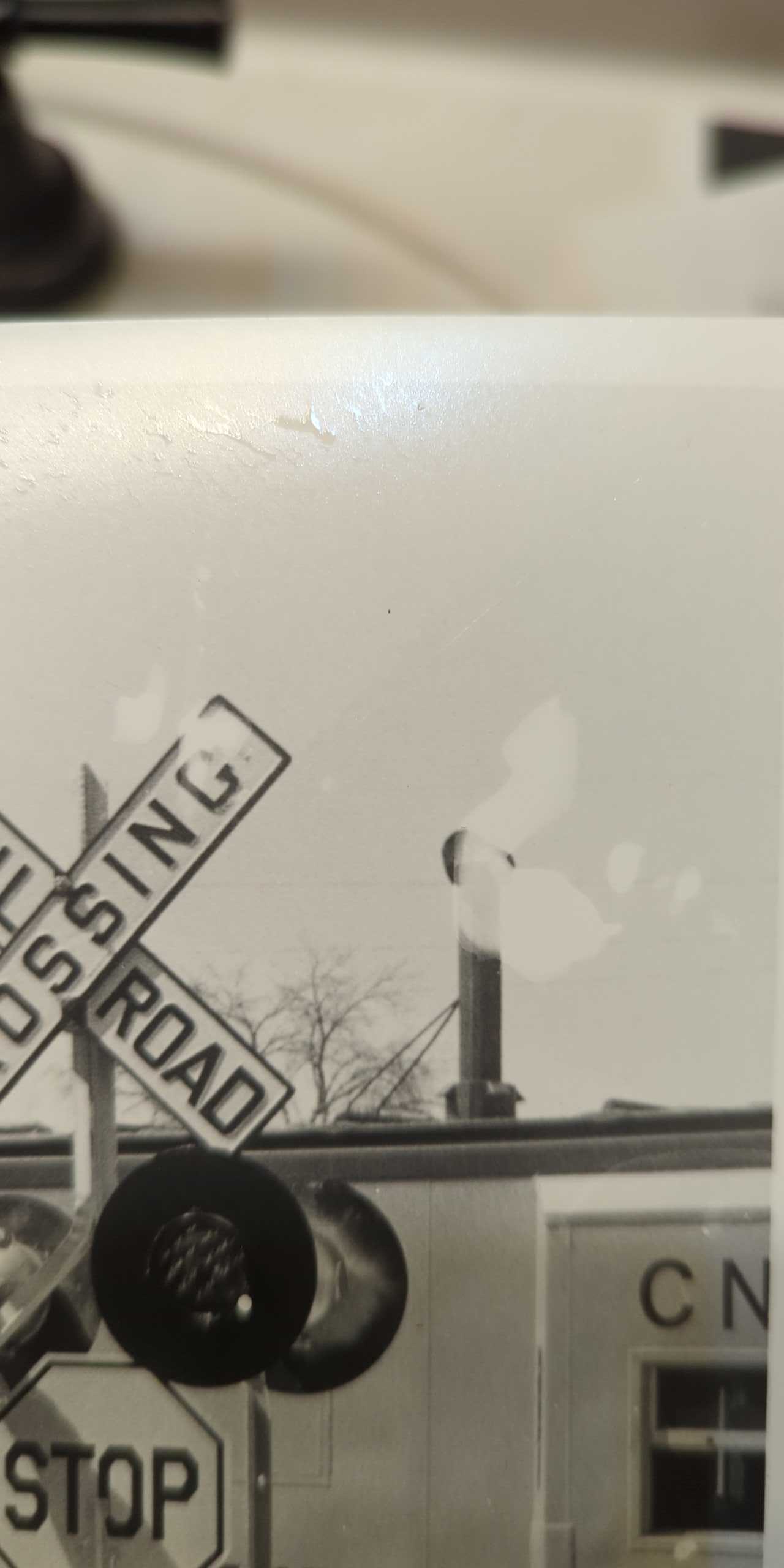

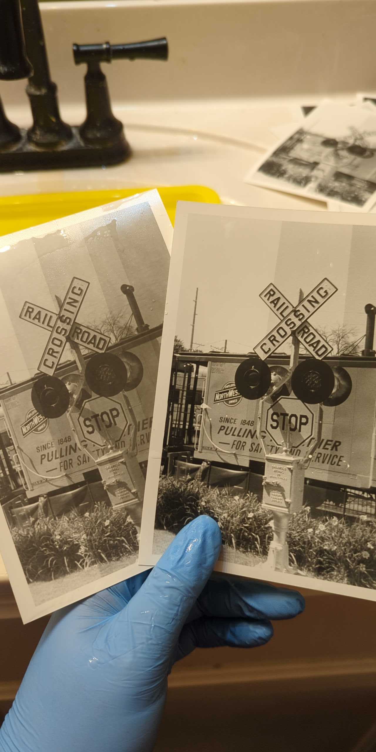

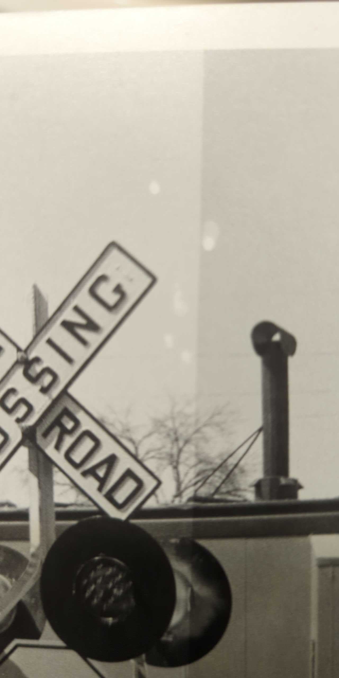

Well... Once again I failed to produce a good print today, but I am happy to report that I can now recognize the signs of an exhausted developer.
The print on the right was taken relatively early in the session. I was struggling with white marks on the prints. I suspect a combination of dust, and uneven development (perhaps bubbles on the print). Eventually I just had to take a break. Came back a few hours later. I think I resolved the white streaks (dusted the negative, improved the way I insert the paper in the development tray) but I can no longer get the same blacks I was getting at the beginning.
Side note --- This cellphone photo doesn't do the print justice. The print on the right has nicer blacks that this photo suggests. Not spectacular, but better than what this awful cellphone photo would suggest.
That should be impossible. Prints are to be agitated the entire time they are in developer.
Yeah. I rock the developer tray constantly and I can see the liquid whooshing back and forth across the print. ---- Looking again at the prints (below), they don't really look like bubbles, but more like liquid drops of non-development.

Developer doesn’t become exhausted through oxidation in 5 hours.
Those larger blemishes: looks to me like you’ve splashed stop bath or something onto the print before development. Go gently with the rocking!
Yes they do.
That makes me think that the developer may be contaminated.
