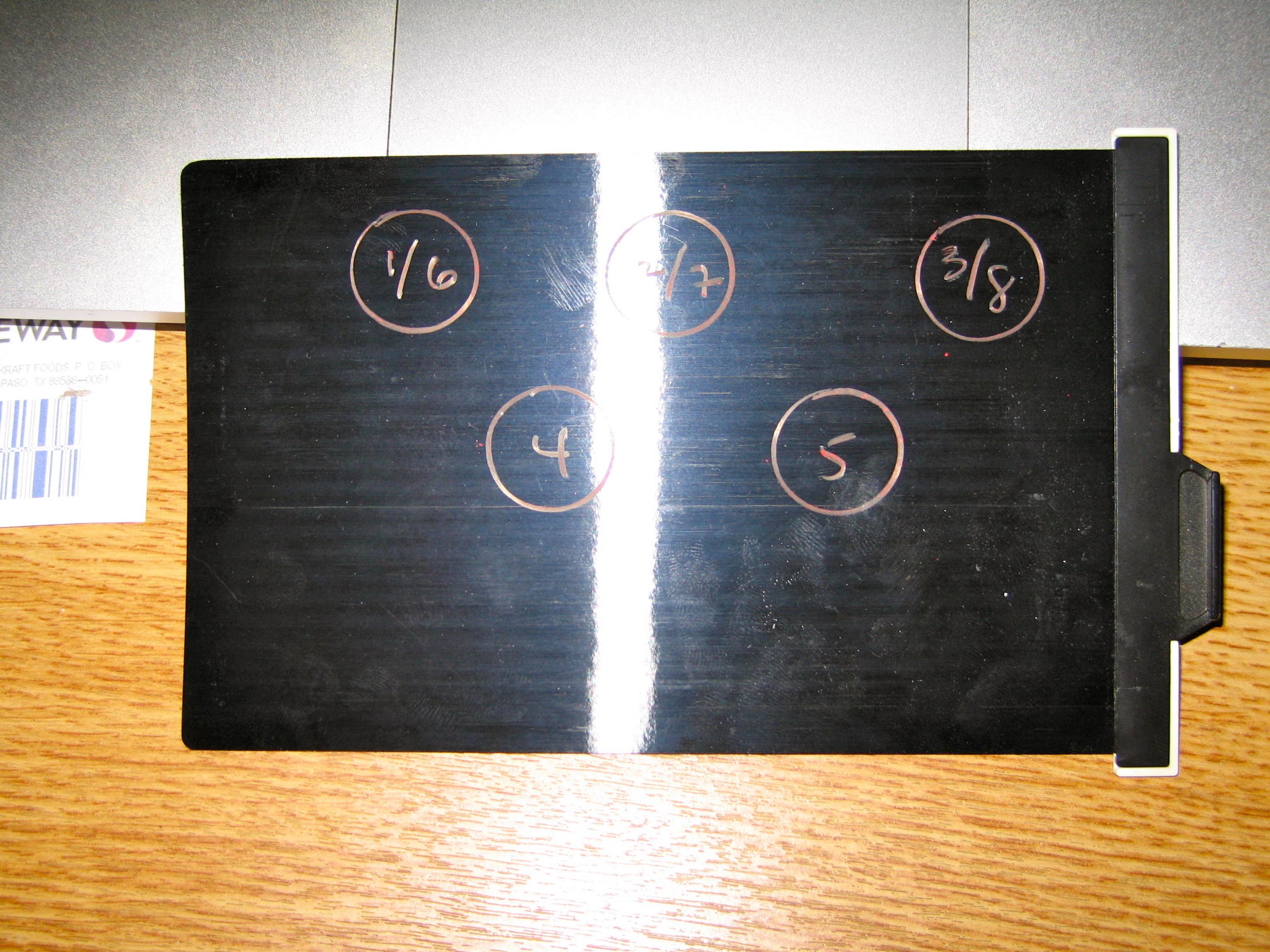

I do a stepped ten exposure sequence (via darkslide)...
When I used to test with a densitometer, I used 5 different drilled darkslides (plus an undrilled one), so I could get 8 zones on one sheet of 4x5. By flipping 1,2, and 3, I'd have 6,7, and 8. Made testing a lot quicker. I've lost them, but it worked like this:
