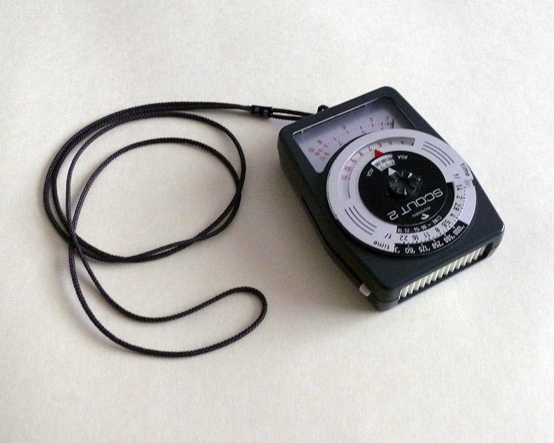

I am going on the usual family outing this weekend to one of the many tourist-packed amusement theme parks, so I went looking for an interesting camera/lens combo in an old storage case. I keep myself sane in these parks by taking along some old camera and lens to fiddle around with. Amazingly I found an old handheld meter that doesn't seem to require batteries!
A couple of years ago I purchased an RB67 outfit from a friend who is a former wedding photographer (he went digital and was going to ebay his old RB equipment, I made him better offer). In one of the old cases I found among other knicknacks a small handheld meter.
It is a Gossen Scout 2 and appears to be of the type that requires no battery. The red numbers on it appear to indicate EV values from 1 to 11. It has a small lever on the side that opens a small rectangular window on the top of the meter. When the door opens, the dial moves to a number. I am assuming this is a reflective meter? I have no idea how old this meter is.
I took a reading from an open window and compared it to a reading from my F3. Both readings are the same. I plan to go out in a few minutes and test it together with my F3.
A lot of Gossens seem to have a retractable incident light baffle - is the "cover" of the small rectangular window made of white plastic?
Yes, it appears to be accordian style white plastic. Even with the plastic in place it appears to be metering. When I slide the plastic out of the way, the needle jumps further.
I'm not sure if I am using it correctly or not, but when I slide the plastic down to expose the little window section and take a reading, the reading is about 1 1/2 stop over or under when compared to a reading taken from my F3.
That's the incident light baffle.

Here is a picture of the meter.
