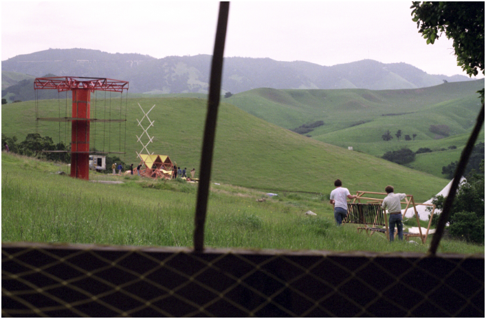

I've found that film kept in plastic sleeves lasts longer. Here's an almost 40 year old example.
This is a recent scan from Eastman 5247 that was processed by RGB in Seattle (remember them?). They used to return "slides" that were really prints from the negatives which they sent back uncut, rolled in a clear plastic sleeve. I kept them as-is until just a few years ago when I cut them and put them in PrintFile pages. The original "slides" from all the rolls of 5247 that I shot back then are hoplessly faded except for one shot, that I happened to put in a glass slide mount. It's "just fine".
Poly Canyon, Design Village, April 28, 1978. Friday of Poly Royal weekend

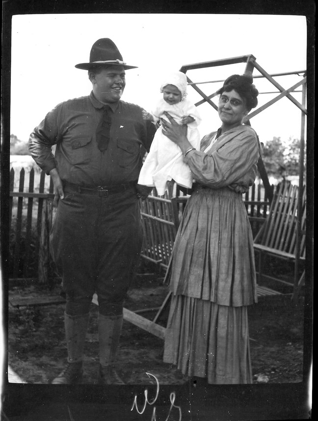

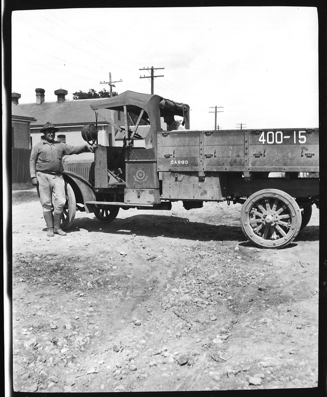

Here's a few I recently printed for a friend, who had received these negatives from a family member. They had been stored in envelopes for decades without any special care, in a trunk in an attic up in the Pacific Northwest, which is an area that can get very damp. He had no idea who was in these photos, so was very happy to see the resulting prints.
Some images had serious cracking/flaking of the emulsion, but others were in excellent condition. Most of the negs were 6x9 and larger, probably taken with Kodak Brownies and/or folding cameras. Earliest photos (below) were probably taken around WWI (1918?), and others probably go up to the 1940's.
I just used a brush to clean any loose debris from the negs, before making contact prints in the darkroom. These are scans of those prints.
