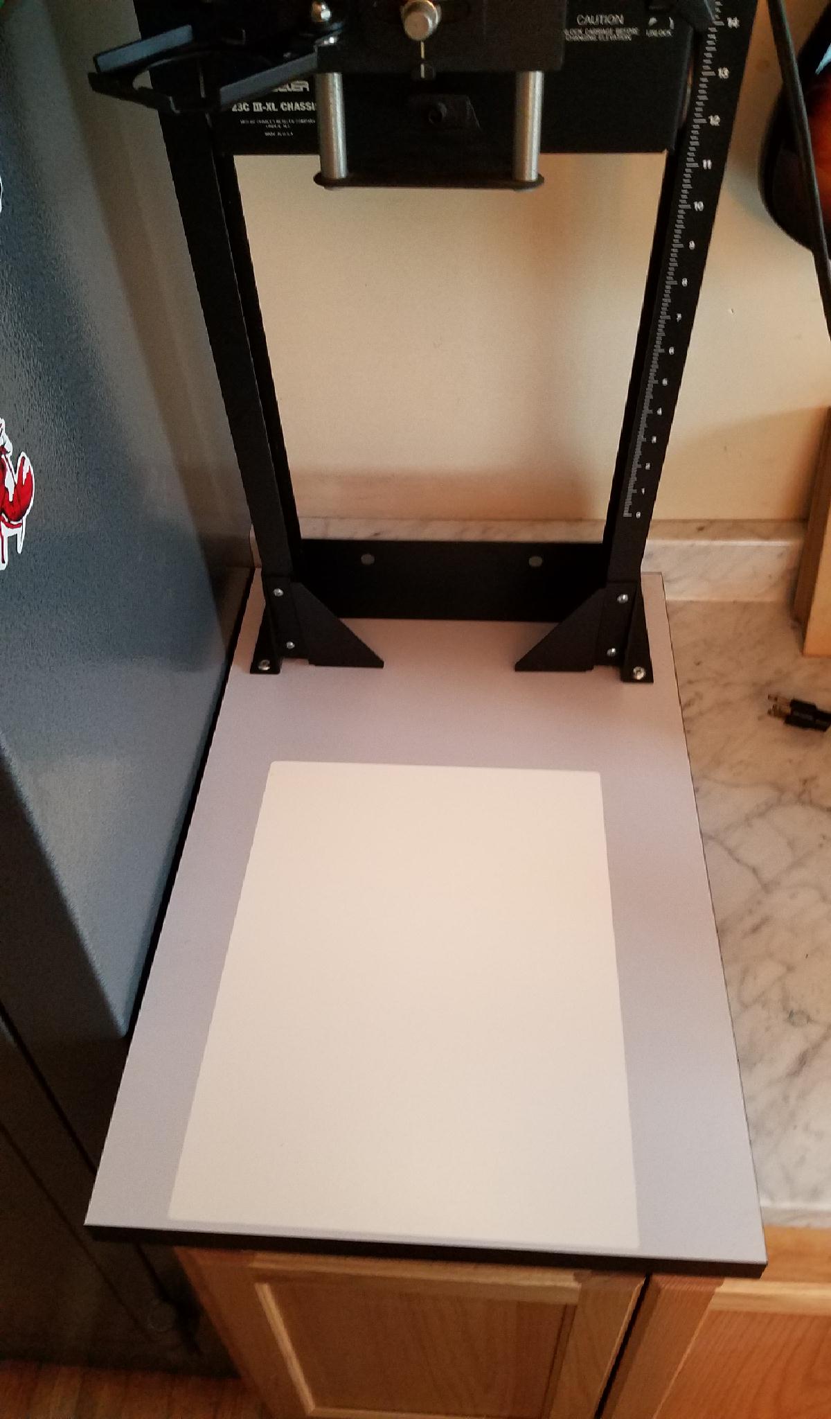

20190330_091746.jpg View attachment 220401 View attachment 220401
I shoot a lot of 6x4.5 with the Hasselblad. The baseboard is 16" wide and 25.75 deep. This photo illustrates the problem using my 6x4.5 neg carrier . . . . as you can see the projected image is about 11x15

ic-racer
Feb 25, 2007
16,542
USA
View attachment 220402 View attachment 220401 View attachment 220401
Thank you for the picture, it really helps to see the issue. This is an interesting problem, because, I suspect the negative cannot be fed into the enlarger so it projects the other way (like a 35mm frame).
Yes, I can rotate the neg carrier 90 degrees but I do no gain anything by doing so.
While the enlarger on the extended chassis is capable of 25x18 at full height and focused . . . the largest image I can accommodate with the supplied base is aprox 11x15

You need a 16x20 easel.:D
If we were neighbours (note the "u" in neighbours) you could borrow my 2 blade version.
Put the baseboard on a table. Build a shelf that is big enough (18" x 22"?) and has legs that will allow the legs to stand on the table and centre to rest on the baseboard.
Thanks Matt! I will go the plywood route and post up a pic of my solution . . . I think at this point in time I w ill just tape the paper to the plywood . . I am very clever!! a 16x20 easle is not in the budget roght now.
Consider putting magnetic paint on the plywood and using magnets as well.
You might be able to find a decent priced 16x20 easel at the Kent WA camera show on April 13th.
