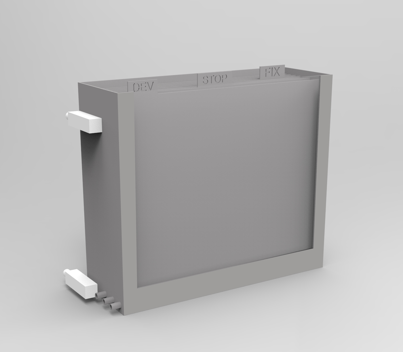

Here's another question: do the trays have to be horizontal?
We could build it with three vertical "trays": dev, stop and fix. The rendering shows a clear panel so you could monitor the development. We'd also have to have a carrier/basket to help lift the print (or negative) out of the solution. An 8x10 version would only have a 12" x 7" footprint.

This looks like a Nova slot processor. Very desirable and quite difficult to source in North America.
Put some caps on the top and make it easy to clean - I'd be interested!

Thanks for the heads up; we had actually not seen these before. Validates our design!
Our goal would be a slightly smaller version, one piece construction and a much lower cost.

Personally i would prefer atleast the developer tray to be horizontal so i can develop by inspection. (and not mis out on the fun of seeing prints appear out of nowhere :smile: )
Having owned a Nova Slot unit, I can suggest that you eliminate the high points that have the words, Dev, Stop and Fix. If you retain those, the paper is going to swing as people slide it over them; solution will almost certainly spray where it shouldn't.
With the Nova unit, and, in in complete darkness, you can pull the paper up slowly and draw it over the lip, thereby reducing cross contamination, then as the paper or film slips over the lip, you drop it down into the next bath.
Nova had clips which worked a treat, leaving two tiny holes, like a snake bite on the edge of the material.
Definitely the best unit for a small place. The Nova, in some instances, was built in to the bench, with, in one case I saw myself, a small router rebate that allowed a custom made top that made the benchtop flat again.
