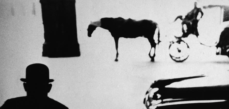

I just got Koudelkas book and found out he had made many of these really contrasty (or binary?) photos. I assume these are made with analog equipment, but how? The book has few more but these are quite difficult to find online .. Not so commonly known Koudelkas work, probably.

Litho film or similar - or possibly litho film used as a mask in the printing steps. Basically it's designed to give almost no halftones (ie black/ white only, with very high density and very low fog) unless exposed to a halftone screen.

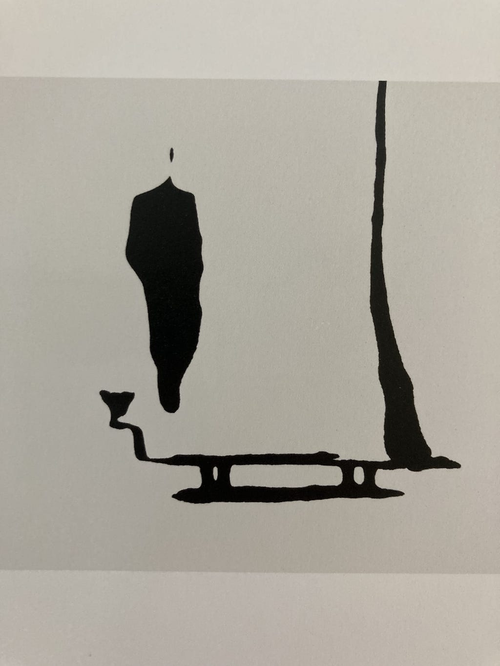

Here is one more:

It could also be document film processed in a normal developer - in fact, that's probably more likely, as you may get some halftone (and was available in 135 canisters readily), but it varies - and you can always then print on G5 to punch out any remaining mids. To put it another way, process CMS20ii in ID-11 or XT-3 or whatever and see what happens.

These are Koudelka's early works - before the Prague Invasion and before his "Gypsies" set. The first two are photos taken during rehearsals at the Behind the Gate theater in Prague - mid-60s, he hadn't even switched totally to being a photographer then, was still working as an aeronautical engineer. So you have a combination of theater lighting, with its extremely high contrast, and (probably) slow film.
Not sure if he had access to very sophisticated film. The major work, though, to achieve the look - for those and for the street photos -, was done in the darkroom, in which he spent hours experimenting.
It would be misleading to call this part of his "style" - he fully became a documentary photographer after the Prague Invasion -, but it certainly taught him about light, contrast and the ambiguities they can created when well manipulated within the photo documentary context.
