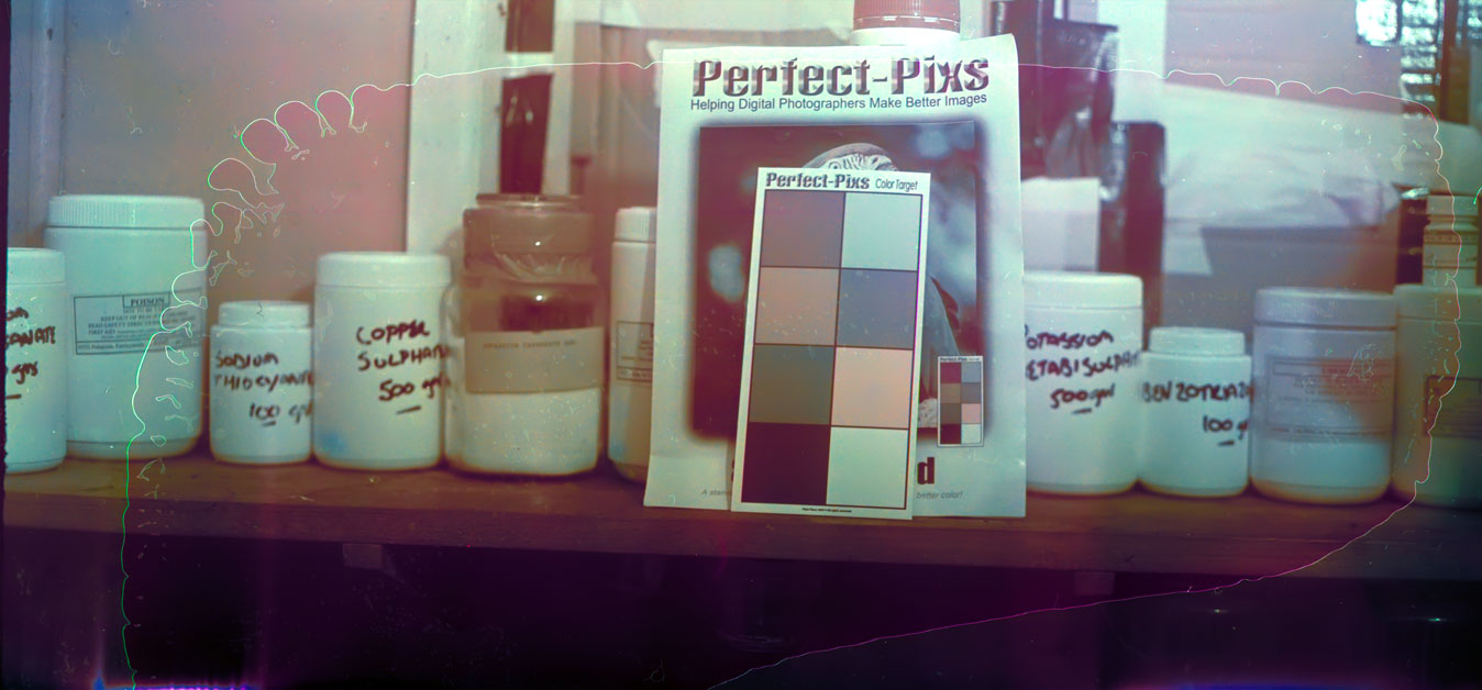

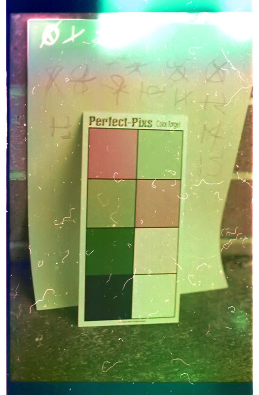

4-aminophenol (stuff in Rodinal) is a type of colour developer, and I would say metol is too, and possibly phenidone. They all have amine groups which results in dye formation. But only when there is no or very little sulphite in the developer. I havent tried since much playing around about 10 years ago. But I shot a colour card (RGB and CMY) and developed on some C-41 film and developed in Rodinal, stopped and rinsed, and inspected the film before fix. The colour is very visible on the surface of the film, from memory both bleach and fix and just fixed removed 98% of the colour. I did a few experiments to try and enhance and increase the colour and then bring it in out post scanning as well. Its strikingly visible prior to bleach and fix.
It needs some kind of mordant to fix the dye and protect it I guess. I have another idea to convert the Rodinal into a colour developer, Ill try it when I
get some analog equipment again.

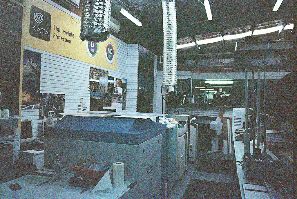

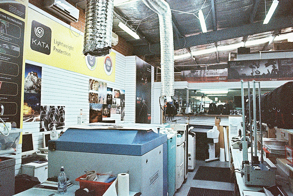

If you're looking for something to play with, Rodinal 1+100 stand for 10 minutes prior to C-41 dev boosts shadows slightly. Extending that further to 15 or 20 minutes would help more I would think. And combining that with pre-flash and pushing the C-41 hard would be something, havent tried it, Ive tried each on their own. Pre-flash with pushing is quite effective when you hit just the right pre-flash amount.
Here is some Superia 800 @ 12800, C-41 dev time of 6 minutes, 38 celsius iirc.
-3 preflash (tissue double folded over in front of lens, metered through tissue for 12800, exposed 3 stops below meter, then normal exposure at 12800 after it - as a double exposure on top of the preflash) - same as no pre-flash
-2 preflash

Those two examples were scanned as a reflective iirc. Given the file name of the first one, it appears I would have developed, bleached and not fixed.
Okay, so the colors we're seeing there are dyes against the milky halide, probably.
