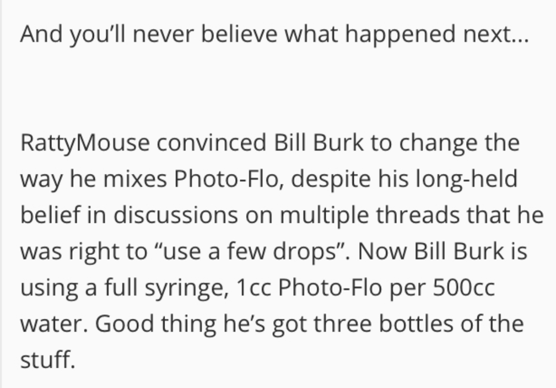

1cc of Photo-Flo in 500cc of water doesn't sound like much even if you type it in a 24 point font. Kodak recommends 1 part Photoflo to 200 parts water which is 2.5cc per 500cc water, so Bill is suggesting a lot less than Kodak. I have no idea how much "a few drops" is. I guess it depends on the size of the drops. I use Photoflo with distilled water and usually don't have a problem with spots. When I do, they are usually on the base side of the film and come off with a little alcohol.
