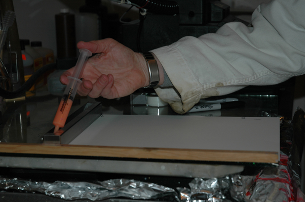

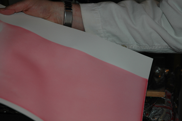

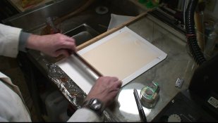

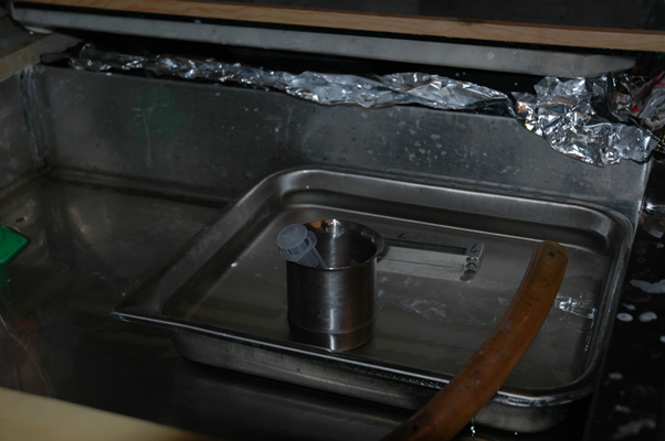

Here is an example of how I coat paper sheets. The example is using Strathmore Smooth paper on an 11x14 sheet to achieve an 8x10 usable size.
The emulsion used actually is a dye made to simulate an AgBrI emulsion that is orthochromatic. This is just approximate, but how it would look coated at the levels used for film, not paper.
I did this so that you can see the coating on the paper.
They are, in sequence, tempering the emulsion and coating blade, charging the blade with emulsion as it rests on the paper, and inspecting the finished sheet for defects.
I have a set on film coataing and plate coating coming soon.

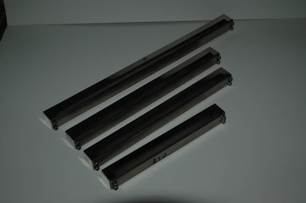

For Bob Carnie
Bob;
Here are photos of several coating blades.
From left to right, 16", 12", 11" and 8". This is the width of usable coated area. The length is based on how well you can pull the blade at a constant rate. My max is about 22 - 24" for the 16" blade.
I've appended a photo of an 8" coating in progress showing the draw. This is a frame that I clipped from the DVD, so you will see raster lines. Sorry. The point of this photo is to show the draw and show the waste at the top. There is also selvege along both sides due to surface tension, and there is a defect at the end when you reach the limit of the coating plate.
PE

Bob;
PE
