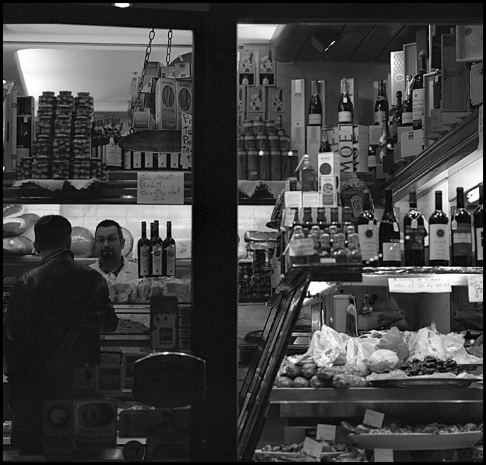

A while back, I went out to try some street photography around early evening. I picked up a roll of Delta 3200 from my stash, and out I went. It was getting dark fast, so I decided to push it a stop and shoot at 6400 EI.
When I got home, I unload the roll to discover it's not Delta 3200, but FP4. Here is what it can look like for nearly a 6 stop push...

That looks amazing, can I ask how you processed the negs re which soup, dilutions and timings?

HC110B - 65 minutes - one agitation every 5 minutes.
I do not enjoy printing these under an enlarger (massive understatement). Scan and tweak in PS before going digital is by far the most viable option... but it works, and that was the point, right? :wink:
