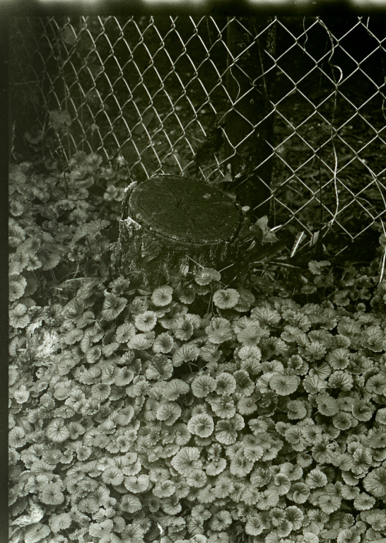

Wow, looks like either (or a combination of) insufficient first dev, or bad bleach. I'd vote for the latter. What should come out, if everything works right, is a reasonably clear slide with the orange mask.
It was all complete guesswork - strength of Rodinal, time in it, how long to re-expose the film etc. I was happy anything happened at all!
No doubt. If you cared about results, it shouldn't take more than a half dozen rolls to get to something at least reasonably viewable.

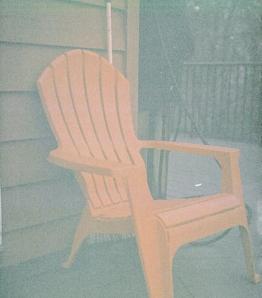

Just once, out of curiosity (or perhaps stupidity), I took a colour negative film and did a homemade basic reversal processing. I think I used Rodinal as the B&W developer, flashed the film on the reel for a guessed 20 seconds in front of a bright light, then ran it through a C-41 presskit. The film came out almost black, but with a very bright light you can just see there are positive colour images. The Flextight managed to extract something more than my eyes could:
I can't say I recommend doing it! But it was a fun experiment.
Interesting!!
Perhaps you already know this, but you can do actual reversal development using a high contrast b/w developer as first developer, light re-exposure,and C41 kit chemistry. We have a thread on that.
Yes, for 2 hours in a warm water bath, flash the film and then process in a diluted developer.
