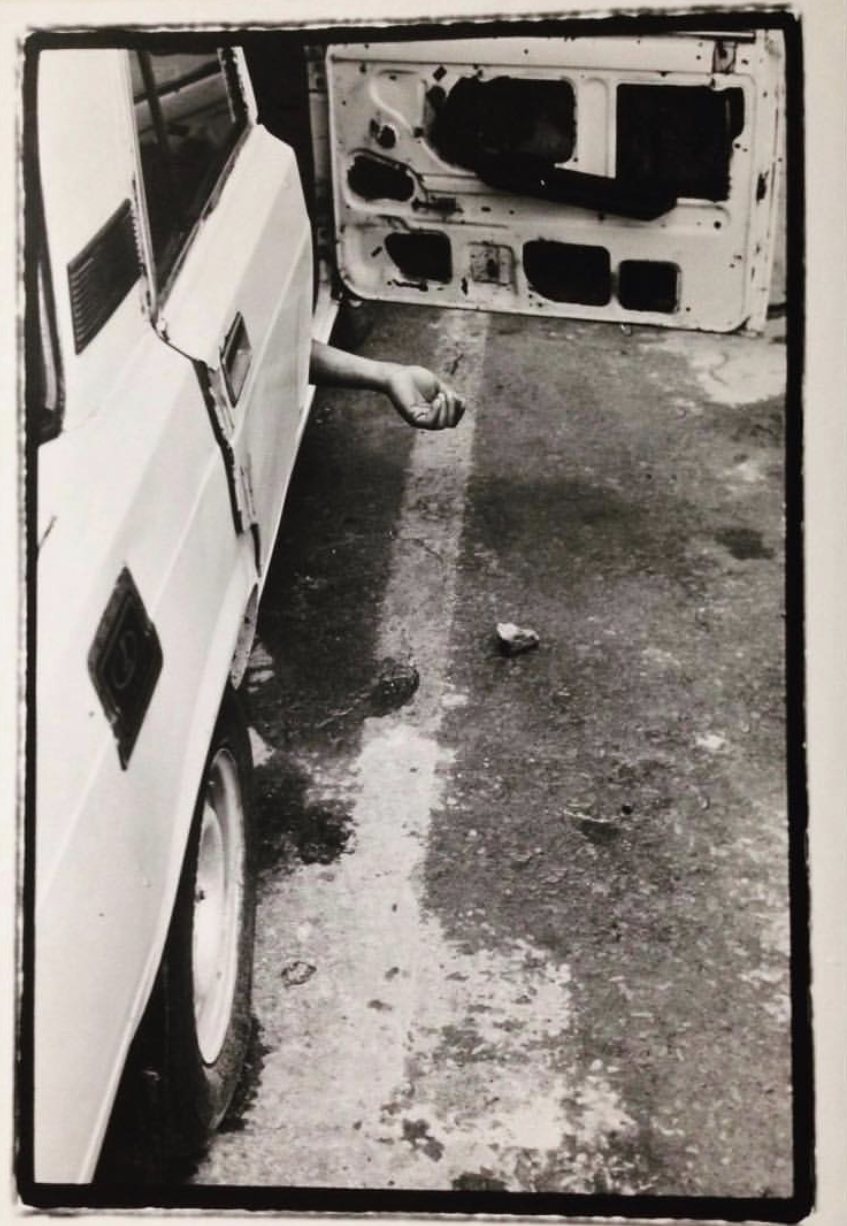

Here are 2 prints. Beautiful stuff.
And remember, ilfosol-3 gives more acuity than Rodinal. Fabulous stuff.

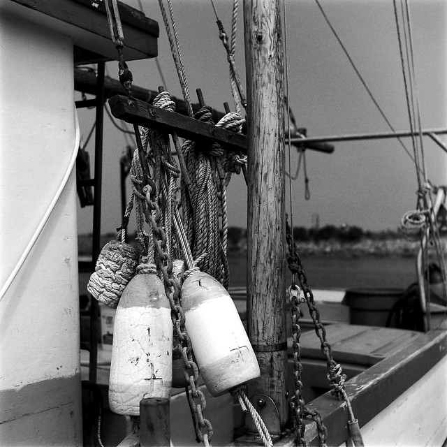

I only put it in a camera if I know I’m going to shoot off the whole roll. I have a bulk roll in 35mm so I can do short loads. I develop it in beer, but then I develop most film in beer. The shot below is on 120 film developed in beer.
Bumpers and Rigging by Bryan Chernick, on Flickr

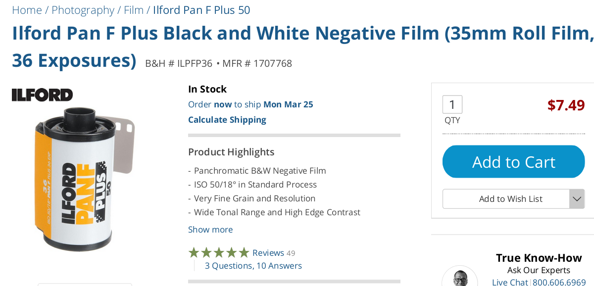

PPS : I got one of the last 152,5m rolls PolypanF = 5 x 30,5 m = 67 bucks = ~100 films =
~ 67 cent per film - so lets have a short look :
OK B&H is realy good from pricing (I've seen it much more expensive - my local dealer is extreme crazy if it goes about this film - but "therefore" he has closed meanwhile:tongue: - no sympathy)
But there is a great difference (factor ~ 11 ) [ 67cent to 7,49 ]
