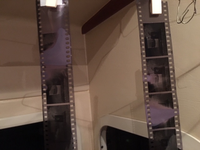

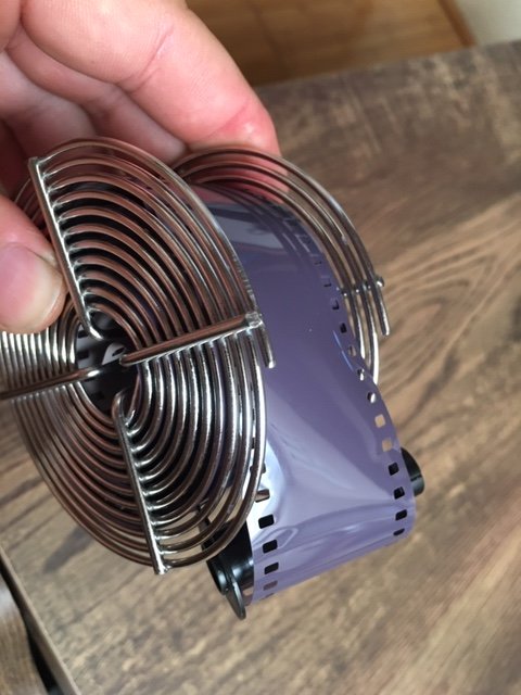

This is the first set of steel reels I've ever used, and I'm finding it extremely difficult, even with my eyes open. I have a hard time keeping the film perpendicular with the reel while loading, and things get off track. I use the "U" shape in my right hand, and load the reel with my left. I've been sitting here for an hour trying to practice and I still can't get it.
What's the trick?

I roll similar to the video, tho I do all 120. But helped a lot of students with 35mm on SS reels -- both 'normal' ones and the better Hewes. With the 'normal' ones, after clipping the leader under the clip I pull it out slightly, wiggling the film back and forth while centering the film on the reel with the fingers holding onto the reel.
From the photo, it looks like you might be pulling too tight as you roll. Good luck!
There is a chance your reel is bent. I spent so long in the dark bag with one of my reels loading film before I realized that the issue was not that I have trouble loading the film every once in a while, but every single time I use a specific reel. I've found good success not clipping in the film to the center hub, so it can self-center itself by sliding up and down. I don't know if this is standard practice but it works for me.
And we have a winner!
Sat here and wound the film on, but every time it went whackadoodle, it was at the same spot. Took the film off, and rolled it across the table, and found the wide spot. Couple of wrenches on each side and it went right on as its supposed to!
