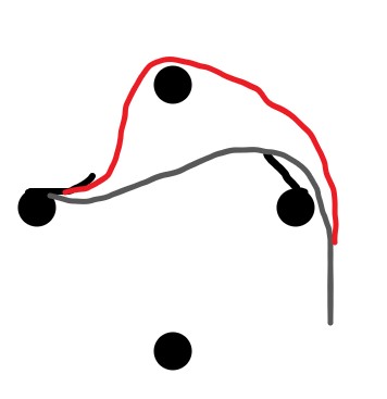

You know what.... now that I'm thinking about it maybe I'm using the reel completely wrong. I bet I'm supposed to go over the sprocket holders, under the center part, and THEN into the clip.
I was trying to go into the clip, then OVER the center part, and I was missing the sprocket holders all together.
I'll try and see how that works out.

There are 4 "cross bars" between the two sides of the reel. The clip is on one, and directly across from it are the sprocket holders. Instead of going THROUGH the center of the reel from sprocket holders to the clip, I was trying to insert the film into the clip and go AROUND the center cross bars.
Forgive this crude drawing. The four dots represent the "cross bars" between the two sides. The grey line is what I'm envisioning - over the sprocket holders, through the middle of the reel, and into the clip. The red line is what I was trying to make it do. In the clip, up and around the reel, and over the sprocket holders, and it just wasn't working.
Ditch the clip...lol, but If I'm seeing this right yes the gray line is what I'd think is correct... By "sprocket holders" do you mean the two slightly bent ends of the reel that protrude into the center space? If so, they have nothing to do with the film's sprocket holes/perforations. They just help guide the film onto the first/innermost portion of the reel. I think if you look closely you'll see they are too narrow/close together to engage the perforations...
Interesting. I thought those upright ends were meant to go through the sprocket holes. I guess I've been doing it ALL wrong then. LOL
That is the way to do it. I never thought about going under a bar and glad that I did not.
