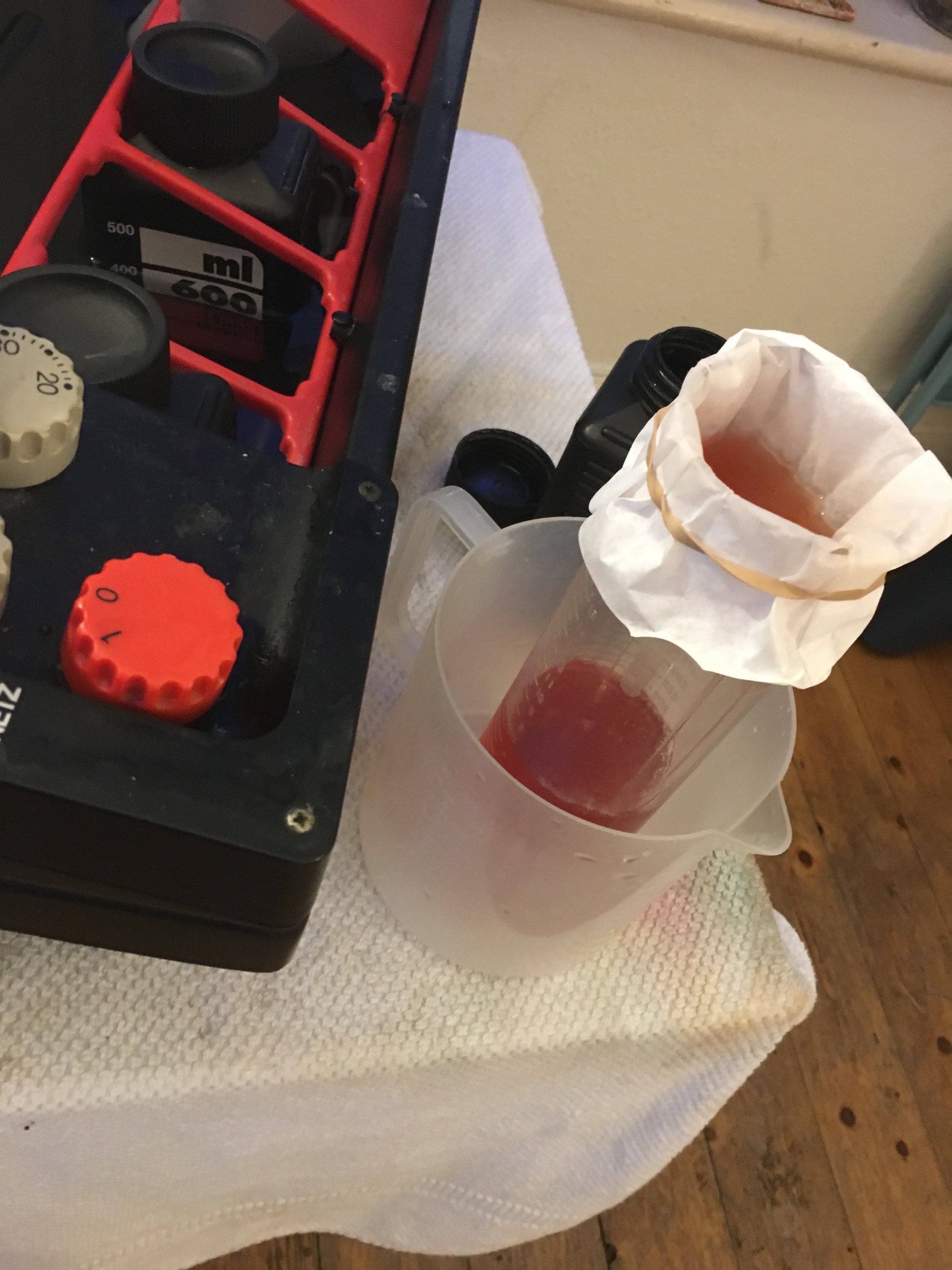

Hello, first post but have dipped in and out recently.
I've been processing my own C41 for a few months and thoroughly enjoying it.
I've had an issue the past few rolls, which I believe is down to my Blix, as I found sediment in it. I've effectively filtered it all out, using double-bagged coffee filters, but I would like to know any methods for testing the efficacy of the blix I have.
I have ordered new chemicals, but I would like to get as much knowledge as I can, so I can troubleshoot later issues, so I'm happy (well, prepared) to lose a roll if needs must.
I use the Tetenal Colourtec kit in a Jobo CPE2.
Thanks
There should be instructions in the kit that tells you how many films you can process with a given quantity of chemicals so really there is no need to test. That is the way I work. I also always give more time than the process suggests, so for the 1st film instead of 6mins I always give a full 6 mins 15 secs and each subsequent film with the same dilution I give an extra 15 seconds until I reach the maximum recommended capacity for that quantity.
