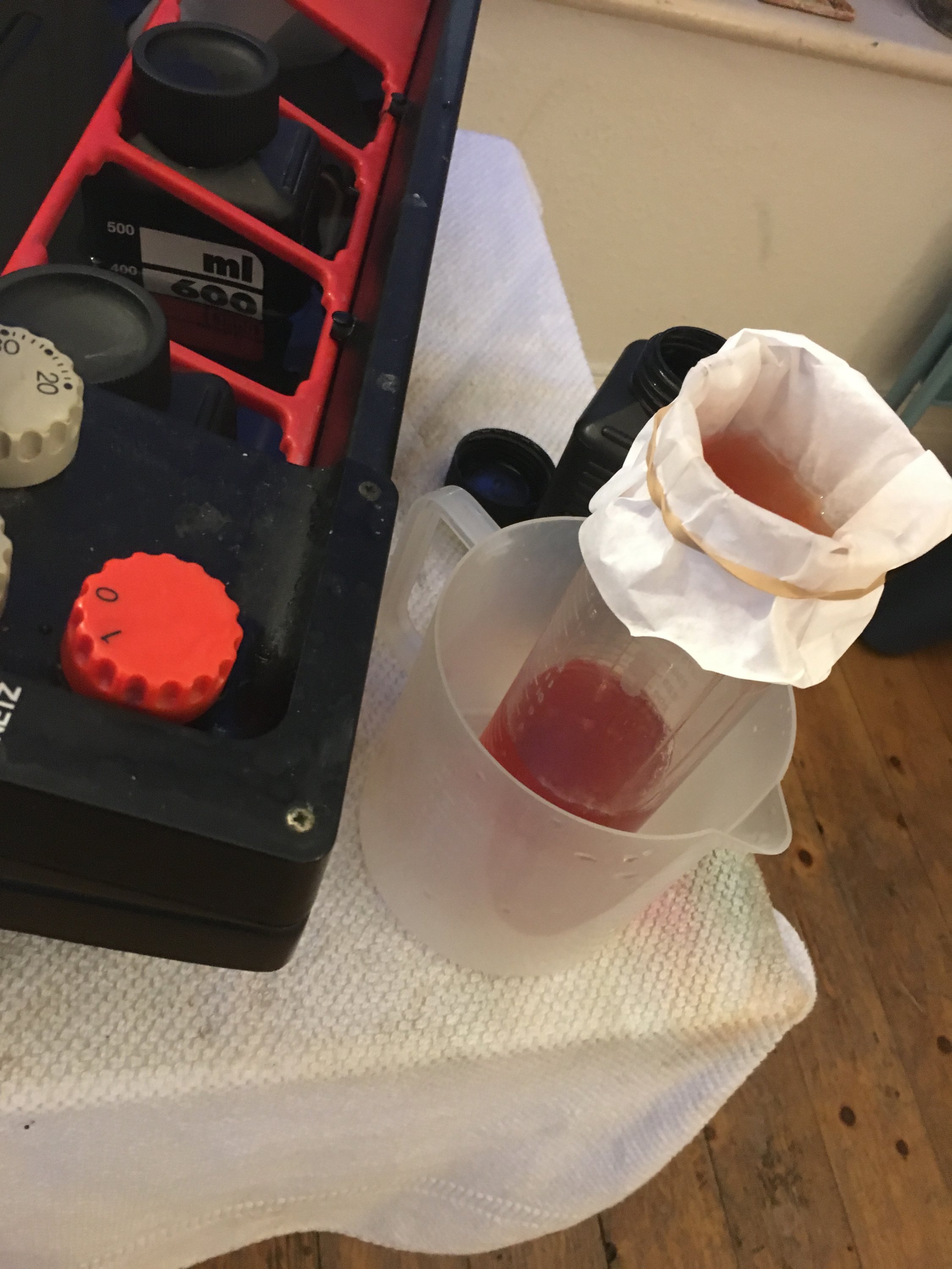

Hello, first post but have dipped in and out recently.
I've been processing my own C41 for a few months and thoroughly enjoying it.
I've had an issue the past few rolls, which I believe is down to my Blix, as I found sediment in it. I've effectively filtered it all out, using double-bagged coffee filters, but I would like to know any methods for testing the efficacy of the blix I have.
I have ordered new chemicals, but I would like to get as much knowledge as I can, so I can troubleshoot later issues, so I'm happy (well, prepared) to lose a roll if needs must.
I use the Tetenal Colourtec kit in a Jobo CPE2.
Thanks
j-stewart
Nov 4, 2006
Mike,
First thing I noticed is that you're using the CPE2, which is a serious tool, and therefore suggests you are a serious photographer. So, how I respond to your question will try to keep that in mind.
First, BLIX is a mixture of two separate chemicals, each having their own purpose for being there. The BLeach removes developed halides (i.e., silver). The fIXer removes all undeveloped halide salts.
The mixture of the bleach with the fixer is not entirely compatible. While the bleach is relatively stable over time and use, the fixer is not. There is no good way to replenish the fixer when mixed with bleach, because exhaustion of fixer is most determined by the amount of fixing by-product that accumulates during processing of film. (I think it's bromides that actually exhaust fixer action).
To test blixing function I do this. At working temperature, process a short piece of any B&W film in the BLIX at working temps and time. If the film ends up being completely clear, your BLIX is functioning properly. If it ends being 'foggy', your fixer is likely exhausted. If it ends up having any density (darkened), your Bleach is likely exhausted. Luckily, if your film suffers from either bleaching and/or fixing, you can re-blix with fresh solution and save it.
Any precipitate that forms in the BLIX indicates things are all f''' up and you should replace the blix entirely. Filtering is just asking for trouble.
C41 bleach will last a long time if cared for (I use mine for months). But it won't last long when mixed with fixer. If your workflow in the jobo permits it, I recommend you mix bleach and fixer separately; replenish the bleach with aeration before each session. Test the fixer as above frequently and replace with cheap thiosulfate solution when needed. Sources of bleach and thiosulfate solutions easily found on the web.
