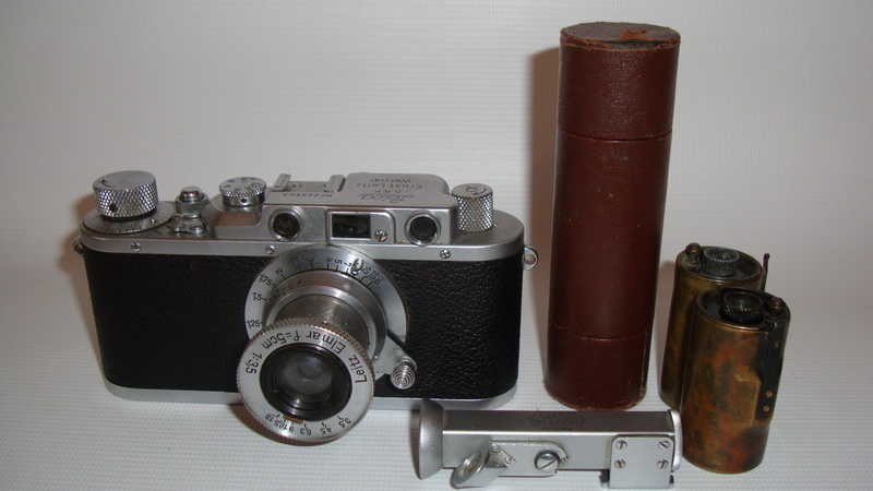

Here is a photo of the camera I am looking at.

After looking over photos of a real Leica IID for a while, I think this camera is real.

Looks good to me, too!
Usually they're referred to as a "II" or a "D", as opposed to the IIIf or IIIg. There was only one edition of the II so it has no model letter designators, IIRC.

Hey, I have that one on my eBay watch list too - I don't need it and I can't afford it, but it looks like a nice deal and a good kit to me. I say nab it if the price doesn't get ridiculous.
