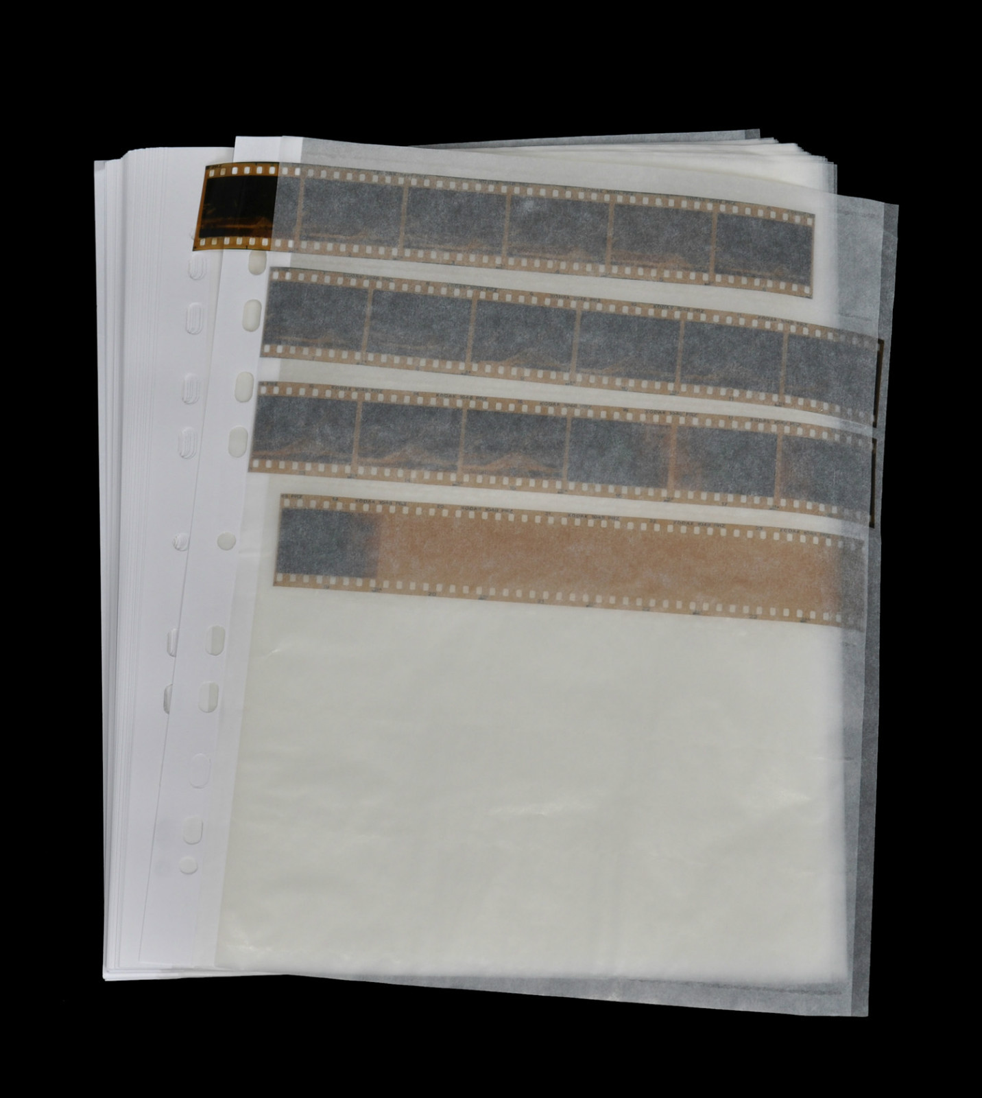

glassines in a metal file box.
+1
I would also add using a archival cardboard boxes. Film can stick to plastic sleeves and be hard to retrieve. The plastic can also leave marks. Glassine sleeves and envelops have be recommended for archival storage for decades.

Where do you get your glassine? I've looked before and not been able to come up with any.
bought a couple boxes of 10, 000 many years ago before they went scarce and expensive.
id like to buy more but b&h prices went through the roof.
it doesnt make any sense why, you still get your stamps and egg rolls in them!

The problem with vertical storage is that the negative sheets are too heavy for the binders: eventually the holes will fail and the sheets will fall off the binders. If you store them horizontally then the binders will not be square and will do the usual mess that happens when you pile up office binders. You can restrain yourself to thin binders (like those that Paterson used to make) or use those clamshell binders that Thomas showed you - and preferably store them horizontally rather than vertically, so the sheets don't get damaged. I buy mine in Germany from this company: https://archivbox.com/photographie/boxen-kassetten/photoboxen-reflex.html - they also sell glassine negative sheets, on another page. Fairly expensive, but my recurring negative problems have disappeared since I started using this stuff instead of office folders, so I consider it's money well spent.
