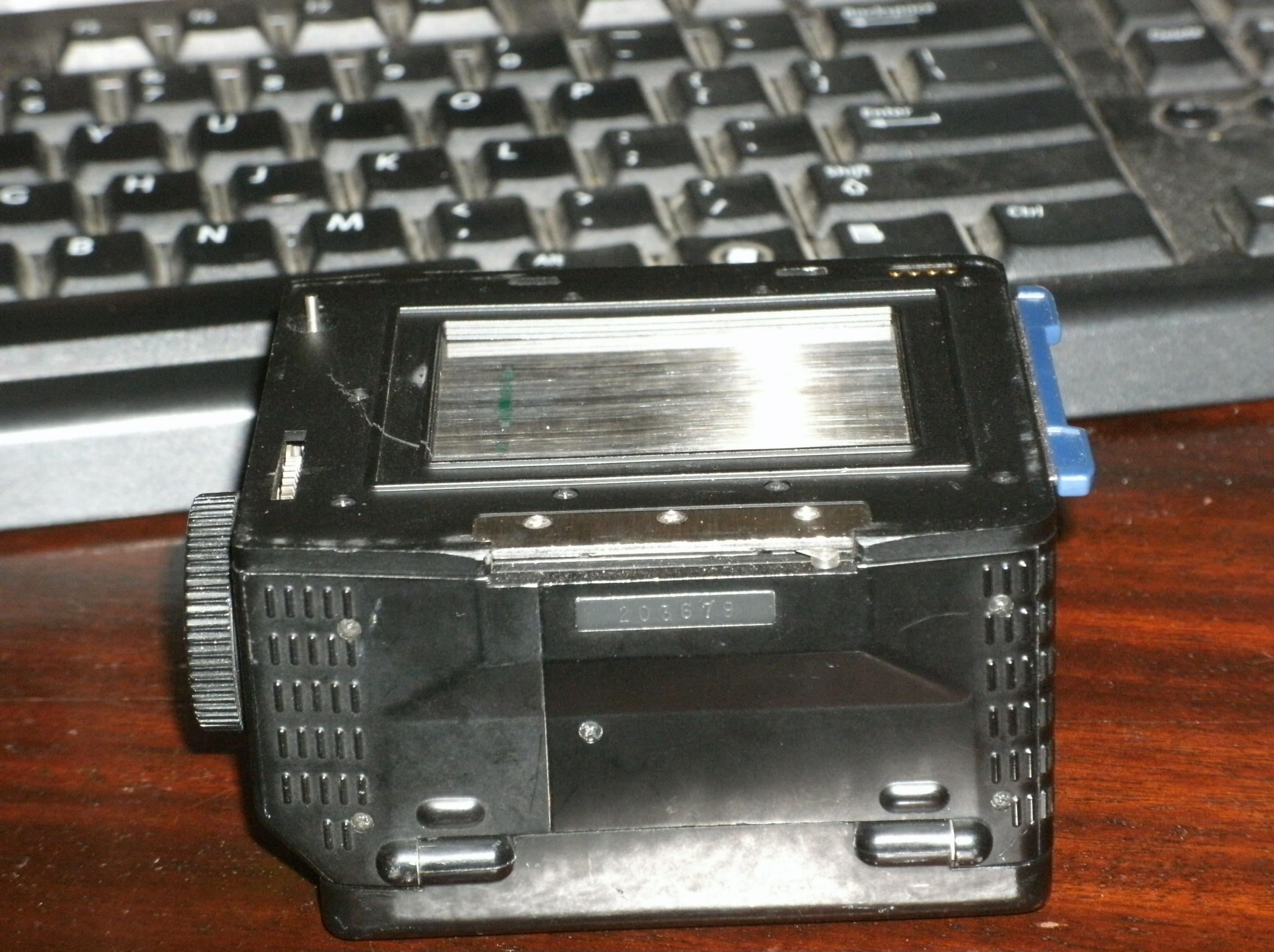

Just got a Mamiya 645 Super with two film backs but have run into a problem.
The film back attached to the camera is missing the darkslide (so it won't let me remove the back from the camera)
The extra backs I have have the darkslide installed in them (so I can't remove the dark slide w/out it being attached to the camera)
So... How can I either a) remove a film back that has no darkslide on it or b) remove a darkslide w/out it being attached to the camera?

I see a pin on the back (upper left corner of back in photo):
But pressing it all the way in does nothing and that is really the only mechanical thing on the back. I tried jamming a hook into the 2 latches at the top of the back (that hold it to the camera) but that also did nothing.
Also @bstark, I would use the slide from an extra back but you can't remove the slide from a back if its not mounted (which is half the problem) :smile:
The 2nd photo is an image of the back of the camera where you can see the mounted back has no slide in it :sad:

Found it!!! Man, it was so tiny and hidden. In the 1st image its a _tiny_ little black dot next to the screw on the bottom right :thumbsup:

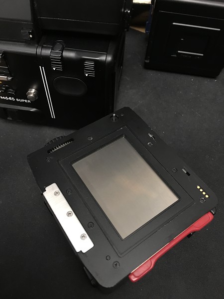

The release pin is behind the metal plate on the bottom of the back. With the mating surface of the back facing you, it's on the right side, a small silver lever that can be pushed to the left to release the dark slide. If you look at your first photo, it's behind the metal plate. on the bottom.
please excuse the dust and dog hair, just getting cleaned up for a trip.

Thanks Rick but I think that is a different back, maybe for a pre-Super 645? Totally agree Sirius, I have my eye on one as we speak :smile:
Sam
It's the back off one of my M 645 Supers.

It is hard to tell from your photo, but I think your backs are actually the fully compatible Pro backs.
There aren't a lot of differences between the two versions, outside of "style" and the colour of the dark slide handle.
