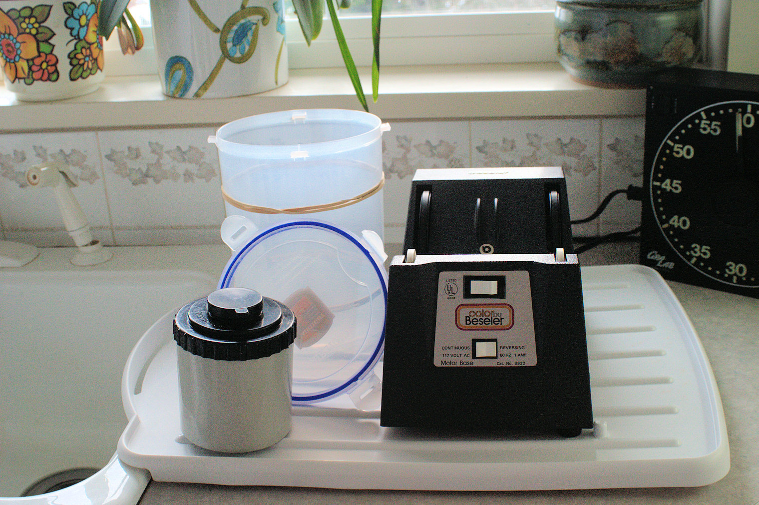

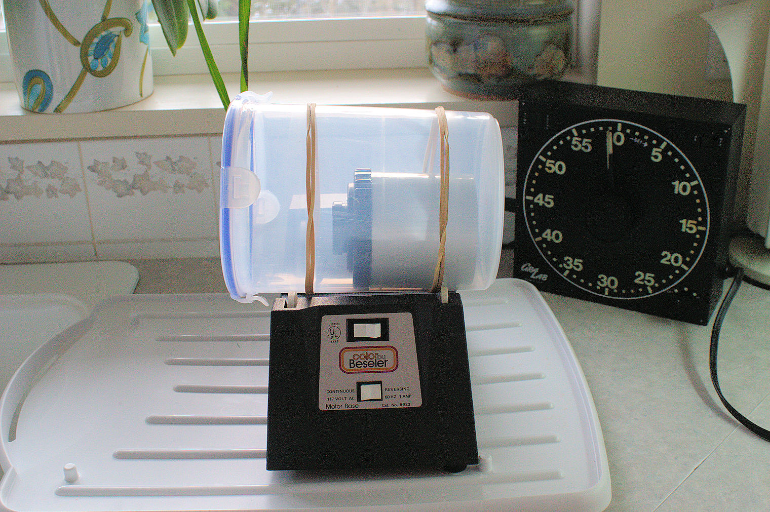

I use either stainless steel reels or Paterson (type) reels. I can do up to two 120 rolls or four 35mm rolls in the stainless steel tanks I use.
After loading the reels into the tanks, and putting the light-tight lids and caps on them, I put the tanks into a fairly large clear plastic tank with a seal-able lid.
The entire contraption then goes horizontally onto a Beseler roller motor - one of the auto reverse ones. I
I work on a counter, beside a double sink.
The motor spins the outer container, and the tank rolls inside it. The clear plastic tank keeps the work area pretty well clean and dry.
The hardest part of putting together this was to find fairly large, straight sided containers. A Dollar Store came through - $4.00.
And now - pictures!:
