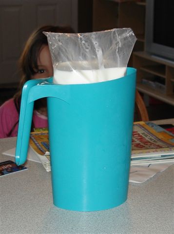

For 4x5, I use milk pitchers (stolen image attached). Can shuffle 4 to 6 sheets at at time with ease. Whole plate film and larger paper negatives in trays. 135 & 120 in three-reel Paterson tank.
