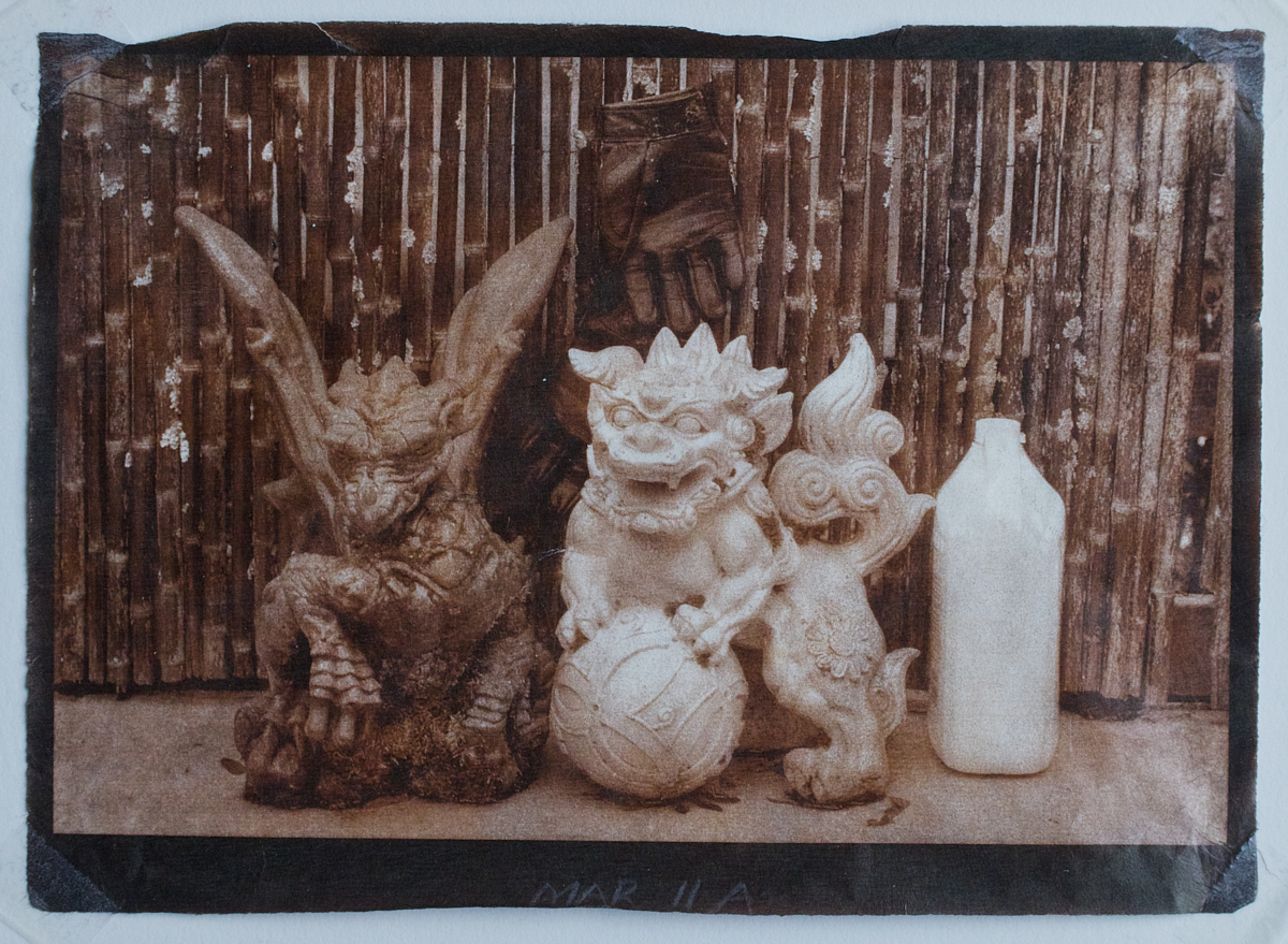

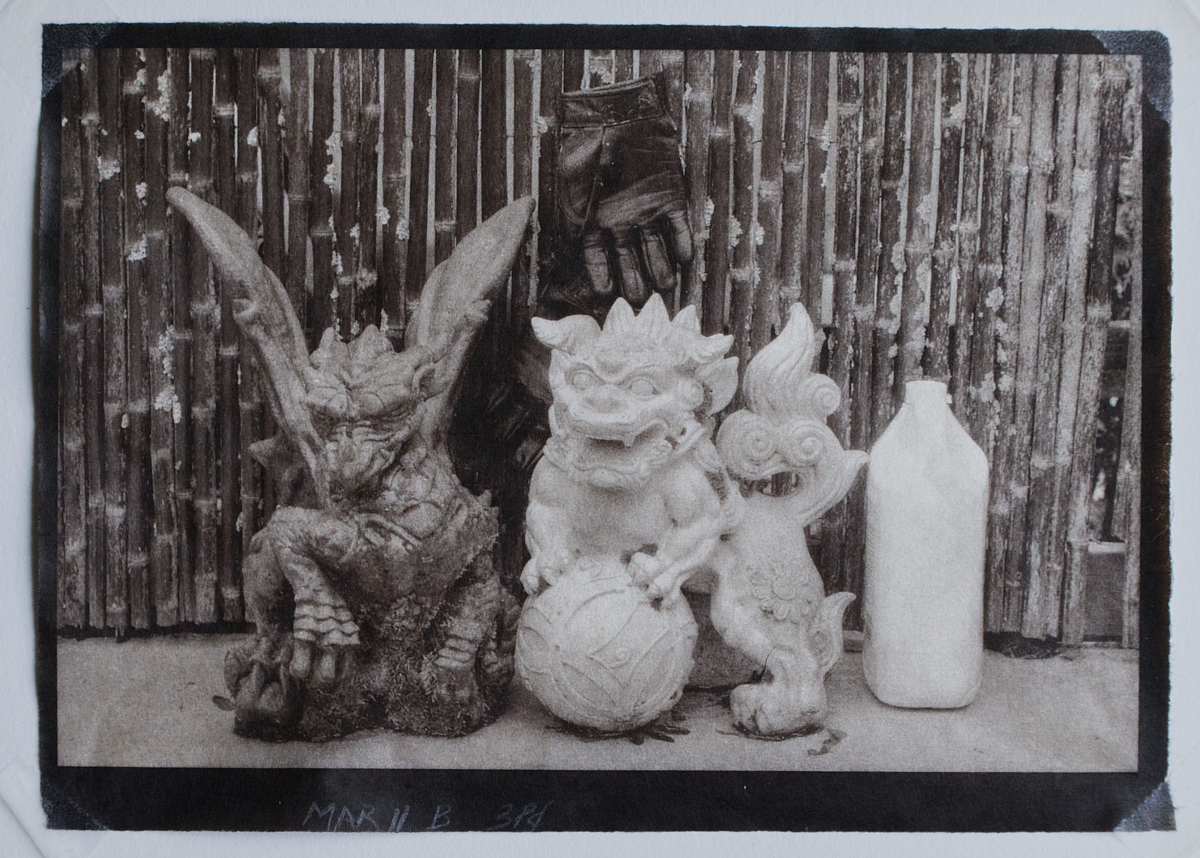

Hmmmmm...
Does an image that's over-toned in a palladium toner get richer in 'warmth' or does it go neutral in colour?
I couldn't find anything Mike Ware had written in his Argyrotype articles about toning, other than to recommend using a more dilute toning bath than you would for kallitypes. I used Sandy King's formula (and dilution) for Kallitypes and toned the Argyrotype below for 10 minutes.
The first is the raw Argyrotype, the second is the palladium toned Argyrotype which is what I'd called neutral in tone, and there was a loss in density overall. Weird. Both received identical coating and processing (other than the second one being toned) except the toned one dried after coating for twice as long (an hour) beccause someone dropped in for a visit.
The dry palladium ( Sodium Tetrachloropalladate II Hydrate) was brown in colour.
Thoughts?

Further musings...
The toned print is 'crisper' in fine details than the untoned print, so the surface of each grain had been changed. Could this have made it more susceptible to over fixing?
One Mike Ware Argyrotype article said to use 25g Sodium Thiosulfate per litre (which is what I've been using) and one of his original articles said to use 20g per litre.
My time was the recommended 2 minutes. That may be too long for 21gsm Gampi?
I'll be using 20g per litre today, and may shorten the time if the repeat of yesterdays toned print has the same loss of density.
Never a dull moment! (see signature below)

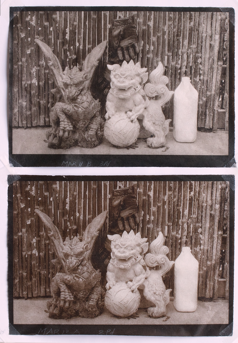

YAY!!!
The Palladium has landed 👍👍
The top print is yesterdays and todays print is below. They are on white paper this time instead of the Rising Museum board I used yesterday. (One of these days I'll have to get consistent on the print to website colour reproduction thing).
Reduced the Pd drops to two drops in 200ml distilled water with 1 gram citric acid. Gave it a 5 minute toning...so half the time with 1/3 less 20% Pd solution. Also reduced sodium thiosulfate to 20g in 1 litre, kept the same time, and reduced agitation by about a half.
All conspired to give the yummy palladium feel I've been envisioning, and the rich shadows & mid-tones are back. Me happy.
