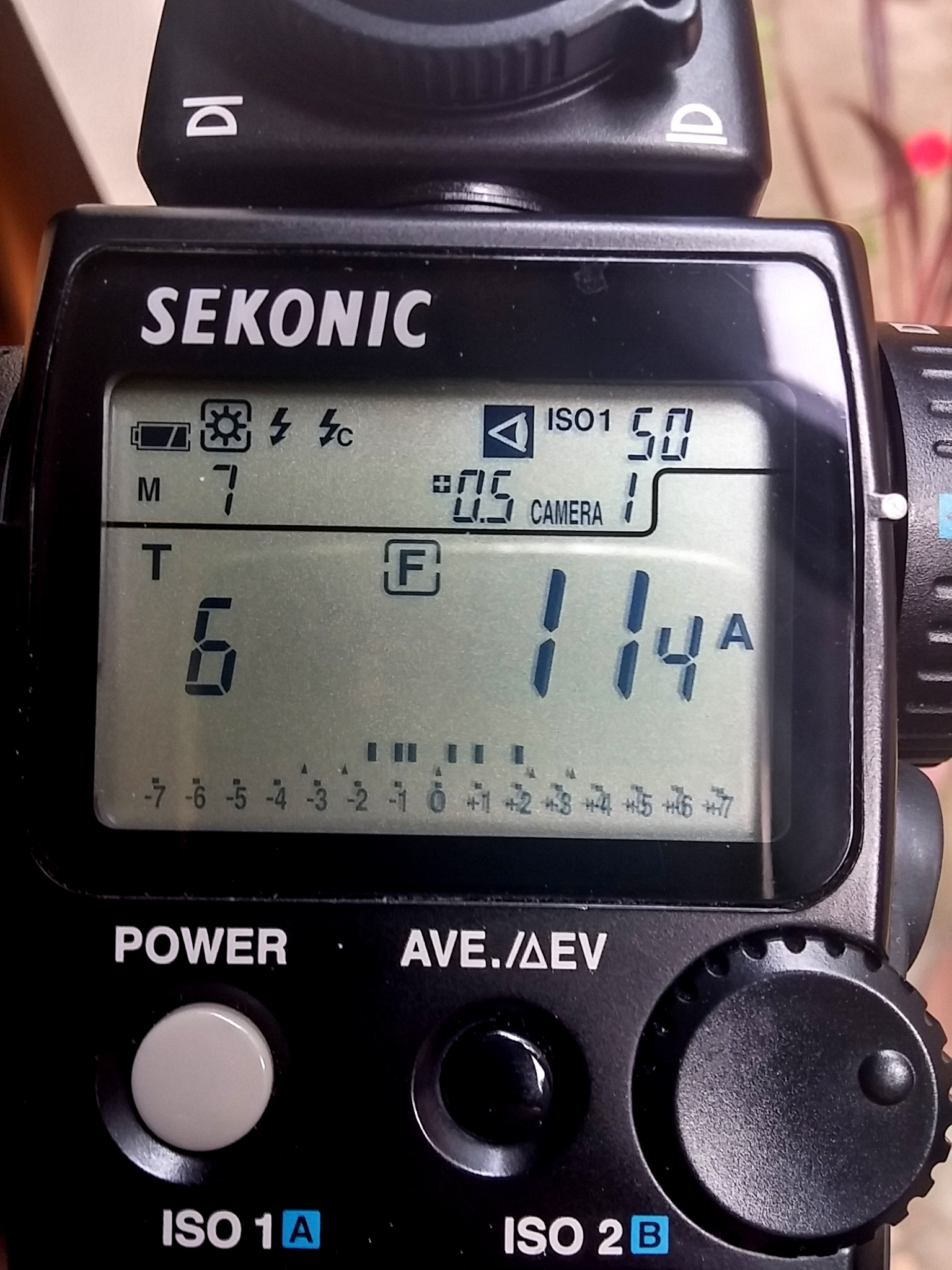

The biggest challenge I find when using the Mamiya 645 when out and about is the metering mainly because I obviously cannot see what I have just taken and also panic sometimes kicks in.
Today, I visited the coast, the weather was all over the place, fog, grey cloud, and then bright sun.
I use a Sekonic L758D handheld meter 100% of the time and this is usually what I do when using the spot.
  1. Meter off a grey card and put that in memory ( for my middle exposure )
  2. Meter the darkest area and put that in memory ( for my shadows )
  3. Meter the brightest area and put that in memory ( for my highlights )
I then look at the bottom scale on the meter which shows the brightness range, if the shadows are no lower than 2 stops below middle grey and the highlights are no more than 3 stops above middle grey the exposure I set the camera to is the Middle Grey Value.
Does this seem a long winded approach, or am I on the right track

IanBarber
IanBarber
Dec 3, 2013
126
Doncaster Yorkshire UK
The sample reading on this photo had light tones, shadow and spectrals. All these were dealt with by multispot along the same lines you described, but no grey card was used as I found my own mid-tone.
Can you please just explain what the bar reads are telling you in the sample image
