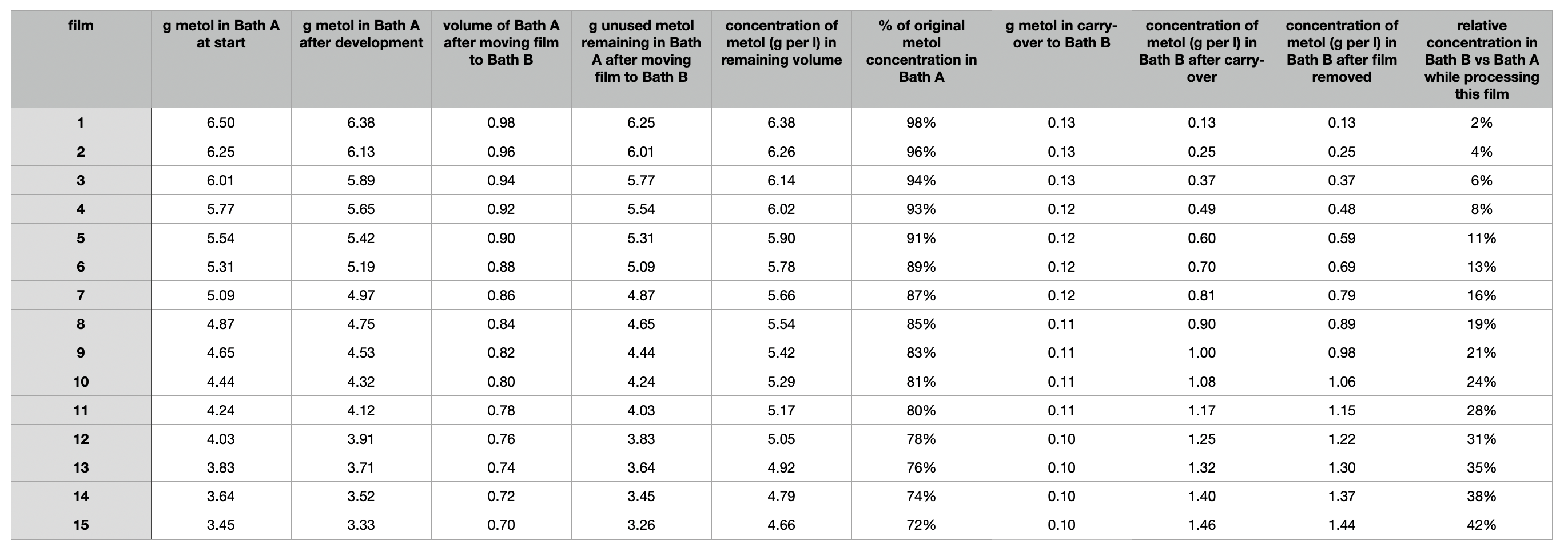

1 litre of BT2B Bath A contains 6.5g metol. If we assume a worst case where development and carry-over are additive - i.e. that each film first reacts with 0.12g of metol and then carries off 20 ml of the solution - the concentration of metol in the remaining solution would be about 81% after 10 films, 72% after 15 films (see table below). BUT even after 15 films there is probably enough metol in the remaining 700ml to develop another 28 films.
NOTE: I’d be grateful if someone could check my calculations.
That excess availability of metol prompts me to mention how I use BT2B, and possibly(?) one reason why I have never noticed any serious change in negatives with increasing film count. I have always felt that my role in Bath A was to keep the film supplied with developer molecules, whereas in Bath B it was to oblige the film to make full use of what it had absorbed. So in Bath A I do continuous inversion agitation, just as you would when developing a print; but rather little agitation in Bath B.
Because the concentration of metol in Bath A will be falling with successive films, the amount of metol carried in each film emulsion into Bath B to complete development would also decrease by about 25% between film 1 and film 15. Maybe this is compensated by the increasing concentration of metol in Bath B? The same calculations suggest that after 10 films the concentration of metol in Bath B would be about 24% of that in Bath A, if we assume that the overall volume of Bath B doesn’t change (because the saturated film carries as much liquid out as it carries in). At 15 films Bath B would contain about 42% of the metol concentration in Bath A.
Clearly my naïve calculations don’t take into account changes in the concentration of inhibitory bromides, nor of sulphite, nor oxidation of metol in the more alkaline Bath B. Nevertheless it does look as though the way this developer achieves its results may shift somewhat during the life of one developer mix. It makes me think that I should include some test exposures (e.g. zone I, zone IX) on every roll and see how their densities change. That could take me several months, so don’t hold your breath!

“Assuming a 135 film contains 0.3g of silver, with 25% being developed, this would consume 0.12g of Metol (sulfate).”
@snusmumriken: Concentration of the developing agent matters. Even though a roll might consume only 0.12 g of Metol, such ridiculously small amount by itself wouldn't be able to develop the roll fully at the pH of Thornton Part A even after an hour in the first bath. To get substantial development in the 4-5 minutes the film spends in the first bath, concentration of Metol needs to be significantly more than the actual amount of Metol consumed by one roll and hence Thornton used 6.25-6.5 g. As you have calculated, the concentration of Metol in Part A slowly but surely goes down after every roll and might need longer development time to compensate for the loss after a few rolls. There was a replenisher formula for the first bath which attempted to offset the loss (you can find the replenisher formula through web search in case you're interested) and ensure the same development time throughout the life of Part A.
A good model! We can assume that x% of development occurs in Bath A, with the remaining (100–x)% in Bath B.
(1) When x = 100, this is the worst-case scenario you described: all development happens in Bath A, so the characteristics of a two-bath process are lost.
(2) When x = 0, the "ideal" two-bath process: Low pH bath A only provide developer to the film, with no chemical reaction taking place. Its volume decreases, but concentration remains constant, allowing use until depleted. The developer carried over with film is then fully consumed in Bath B, whose composition also remains almost stable. The development progress and silver reduction depend mainly on the amount of developer carried over, not on time.
(3) In practice, x likely falls between 0 and 100, with reactions occurring in both baths, for many reasons. The solution composition will change but slower than in (1). Further study would require measuring solution components (e.g., checking if Metol concentration changes match predictions after processing a certain number of films, consider adding some as replenisher and replace Bath B), or, as you said, observing the film for any significant differences in density.

In your story I think the implicit assumption is that the metol carried over from A to B in the swelled emulsion is used to develop silver. Given the lack of an anti-oxidant in B (apart from carried over sulfite from A), I'd expect any carried-over metol in B to oxidize fairly rapidly.
I agree with your conclusion that the activity will shift and I expect that densitometry on some properly controlled test strips will show this.
I didn't actually make that jump between Bath B carry-over and developing activity, but yes, that is what worries people. In reality, one can return to the darkroom after weeks of absence to find Bath B has become a vivid orange due to oxidation of the carried-over metol. It still does its job.
As stated, this was a worst case calculation in its other assumptions too. I doubt that any of them reflect reality. Only experiment will find out, but in the meantime we can just enjoy using the stuff!

Sure. But how much viable metol is in it at that point? That's what part of your argument relied on:
I think that part doesn't quite hold true and in practice will turn out to be more complex.
