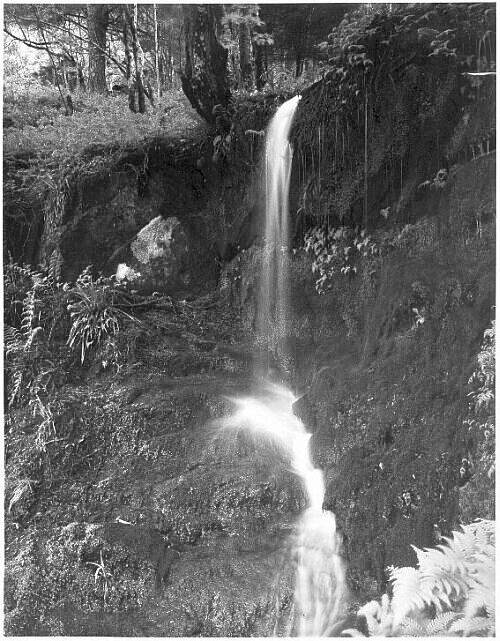

I haven't tried the "multi-click method" with a bucket of water, but it has become more or less my "standard method" of dealing with running or falling water.
It gives a result i feel is closer to our perception of streams - as both smooth and sharp at the same time, detailed and soft, and...
