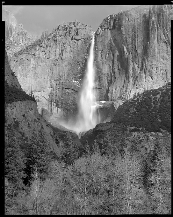

This waterfall was taken at 2 seconds. A large falls from a long distance. Might be too "silky" for some folks, not enough for others.
As with any "special effect", the image should not depend on it to carry it...but instead add to the over-all image (or one runs the risk of creating another example of a cliche).
vaughn
