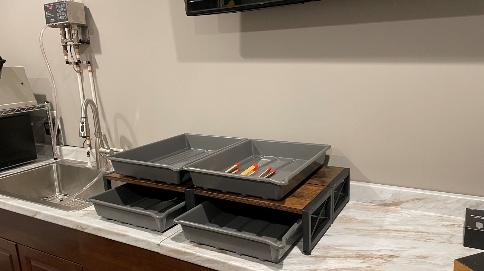

OK, for all you tray uses, how do y'all stack your trays (if you stack)? Those old Ledal tray stackers were nice, but rare and I've never seen them for anything but smaller trays. These are 11x14 trays and I used a few small monitor stands to use as a stacker. I could take the ends (they screw into the boards) and insert a longer board between them for stacking larger trays up to 20x24 - might do that next.

Nice tray stacker.
I should make a few of these myself to get a larger print size than what I can do now.

That's a great setup. I have giant sinks that I have scrounged up. My last darkroom I had a nice long counter and a regular kitchen sink worked great!
