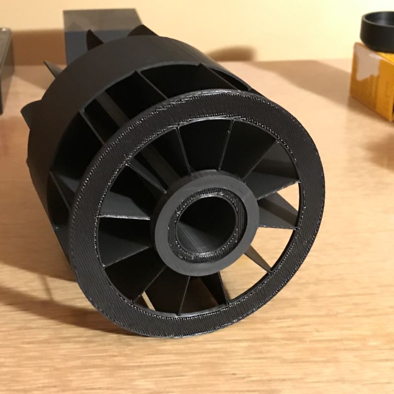

Sadly no, there's not enough room in a 3 reel Paterson tank for that kind of film holder to take 9x12. The max is about 83mm width before you're out of space between the agitator column and tank wall. Can't make the tank larger in diameter and can't make the center column smaller or the funnel won't fit.

I'm only speaking to my design where 12 sheets are arranged radially, changing geometry could get the sheets to physically fit in the tank (such as with the B's 4x5 holder), but I doubt you'd be able to fit 12 (there you would only fit 6).

For reference, a 36 exposure roll of 35mm is 80 sq in, and 12 sheets of 3x4 is 165 sq in, so it's about the same as two rolls of 35mm. Assuming you're using HC-110 (which I'm referencing because I'm familiar with it) and their recommendation of 6 ml concentrate per 36 exp roll, it's 1:66, or approximately the same as HC-110 dilution H, 1:63.
That said:
Now different developers will have different capacities, but even then, I doubt you'd run into exhaustion issues doing the equivalent of two 35mm 36 exp rolls in about 1000ml in a three reel Paterson tank.
Plus, the film holders I designed always allow you to use any number of sheets from 1-12. They just can't accommodate 9x12.

Does your design give consistent development all across the film? I can see how this would be a problem. The flow pattern along the edges is likely to be quite uneven.
It could probably be improved by adding slots to the bottom plate and lifting the whole holder a bit off the bottom of the tank to facilitate the flow of the solutions.
The bottom of the holder is an open frame, so there's no need for slots, it also sits about 3mm off the bottom of the tank. The center part mimics a standard Paterson 3 reel column, so it has the same fill characteristics.
Thank you for clarifying this. I have concerns about the area marked in the photo that potentially creates uneven flow of solution during agitation.
I suggest that the bottom plate could be made to resemble that of the normal reel (with arc slots) to ensure more even flow.
It was not clear from the first photo if the holder is meant to be used without the center column. If this is the case a few extra millimeters gap would still help in creating a better flow (you have plenty of space at the top to accommodate this).
This is an awesome design! Once again, thank you for creating and sharing it.

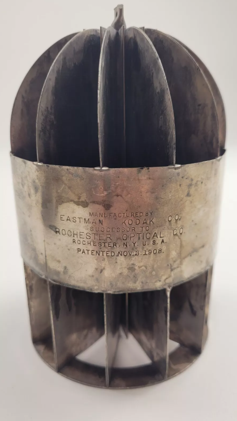

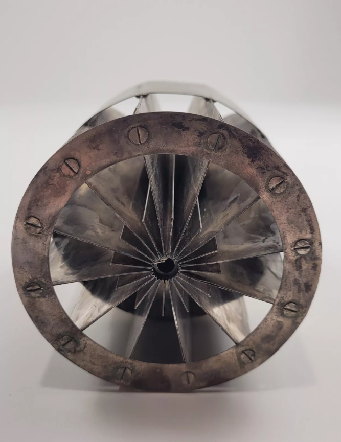

Possibly, I just basically copied the inside of the Kodak film pack tank when including that aspect. They didn't seem to have concerns about uneven agitation when designing that, and I haven't had any issues either, so I'll probably just leave it be. If anything, I would think changing to a solid plate with slots would restrict the flow of developer more, which would lead to less even development due to increased fill time, but I could be wrong on that.
And yes, to maximize space for the sheets, this does completely replace the original center column. I assure you there is a gap between the bottom of the tank and the bottom of where the sheets fit, it's a slightly larger gap than where it would be if you were using the roll film reels.
I think so, yes. That is to say, I'd certainly try to remove as much material as possible along the outer ring along the bottom. But to be honest, the whole arrangement with the folded sheets makes it liable IMO to surge marks.
I also understand and accept that @Hunter_Compton hasn't run into any issues yet; I'd say 'knock on wood' and hope it stays that way. Problems like these can pop up with specific combinations of developer and film more easily than with others. For me, 510 Pyro has always been more of a concern than, say, XTOL/Instant Mytol, to name one example that comes to mind.
