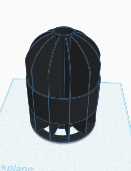

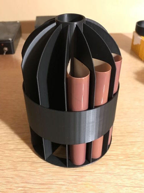

Since I have a 3x4 Graflex RB and a cheap source of large format roll film I can cut down, I wanted a better developing tank option than what was available.
What I ended up doing was designing and printing my own insert for a 3 reel Paterson tank. It is based off the 1920s era Kodak film pack tank. It can hold up to 12 sheets of 3.25 x 4.25" film and will develop 12 sheets in 800ml or 28oz of developer which is a lot more economical than most of the hanger based tanks out there. Fluids can also be exchanged in daylight as with roll film, which is something that neither the original Kodak film pack tank nor the hanger based tanks can do.
Now the film does have to be flexed like a taco and then inserted. I primarily use cut down aerial roll film which has a thin base and this isn't a problem. I have not tried developing proper sheet film with a 7 mil thick base but I have tried some old light struck film as seen in the image above and it does fit, albeit a bit snug. Dimensions can't be increased any further due to size restrictions of the Paterson tank.

That is an ingenious design! Are you open to share the design? I happen to have a 3D printer as well, but have never attempted anything this tall.

As long as you're using it for personal non-commercial reasons I'd be happy to share the design.
If your printer isn't up to the task, I could potentially print you one, provided you reimburse me for the material cost and shipping.

Does your design give consistent development all across the film? I can see how this would be a problem. The flow pattern along the edges is likely to be quite uneven.
In my experience it’s been perfectly fine, no uneven development. Bear in mind it’s only for submerged development not rotary, so unless you’re using very short development times where fill and drain related times matter, I’m not sure how flow pattern would matter.

The one I made will handle 2x3 as well, it just goes with the long edge parallel to the bottom rather than the short edge with 3x4. The design could even be shortened if desired for only 2x3, but then it would fit in a 2 reel Paterson tank.
