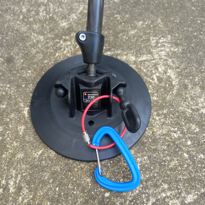

Would not even dream of taking an LF rig out in what is, to us in Australia, greater than 60km/h wind!
Historically a few people in Australia have had LF cameras destroyed after they have fallen or been blown over, and inattention/distraction and lack of preparation for conditions are behind these. It's pretty confronting to see an owner reduced tears as he/she surveys their wrecked camera on the rocks...
A LF camera has much more bulk than a 500C/M (a colleague has used this camera successfully in violent gales [>100km/h] in Antarctica some years ago), with the extension of the LF bellows acting as a sail-catch! Really no amount of thorough preparation will stop vibration and stutter with such a big rig. Would suggest seeking shelter like an alcove or something similar. Another alternative is to have somebody stand beside the camera and essentially serve as a windbreak. Never use a tripod with fully-extended legs and elevated centre-column in windy conditions. Splay out the tripod legs to place the centre of gravity lower to the ground, and clear of real and potential hazard like tidal wash (if on the beach) or airborne dust. Increase the footprint size of the tripod feet so that it is more challenging for the wind to physically push the tripod around (see pic: Manfrotto sand-/snow-shoes for beach use). I use these sand-/snow shoes wherever I need a larger, ultra-stable footprint other than the spiked feet on the tripod. Also, remove all straps, from the camera and from the tripod.
The highest wind I have (struggled) to shoot in is 46km/h; and that requires all of the foregoing preparation; The pic was done, but it was not all that impressive considering how much better subsequent pics were in calm conditions!
