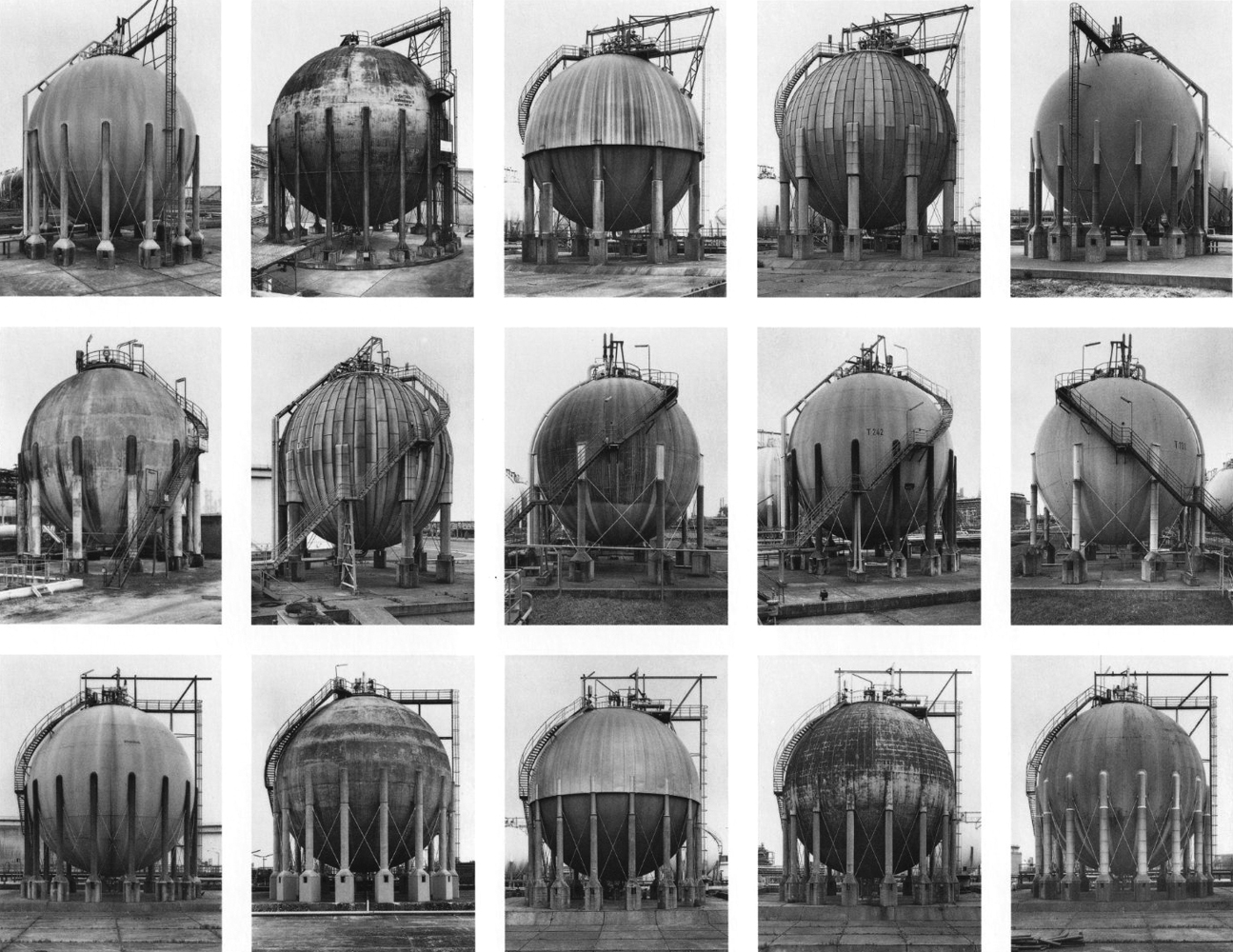

The Bechers waited for similarly cloudy days to get their work done:
