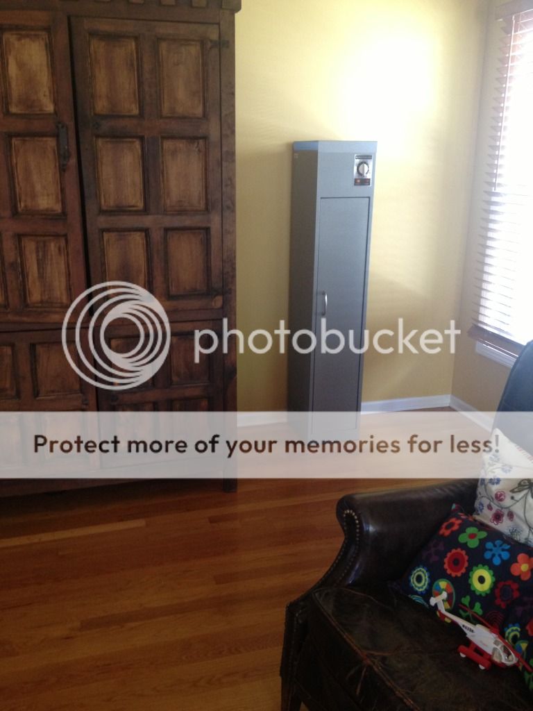

I've said piece of equipment, however I'm not too sure how to situate the film with these bars that came with it.
There seems to be less than four feet of drying space (top to floor) which holds about 27 35mm frames before hitting the floor, then the rest are all buckled and just not elegant. Anyone have one'a these and know how to setup the thing up? I'm not seeing anything after a few Googles, so I'm askin the experts :smile:

^Yep, that's as high as the film can go. Above the "film top part" is a heater and fan. The top 25% of the unit is a heater/fan....here's the whole thing...

You seem to be missing the "C" shaped weights which are used to form a loop of 35mm film. The film is attached at both ends to the top and then weighted by the clamp which only contacts the base side of the film. The film should be wiped with a very dry but damp sponge before placing in the cabinet to prevent contact marks at the end of the loop.

Ron thanks for the intel!! Are these weights and clamps outta my league to make myself? I am ok with tools, no arch welding or German metalcraft skills though :sad:
I can't seem to find a decent image of one'a these cabinets with the weights/clamps to even visualize what you describe....should I do as Matt suggests below and call it a day?
