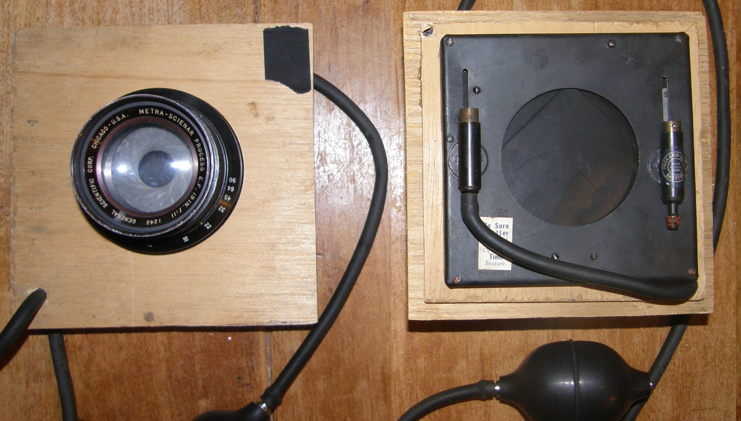

Missing retaining rings aren't really a problem. My DIY solution is to make my own lens boards by gluing thin plywood layers with the grain at 90 degrees to each other (---, then | ). Then you drill a big hole, hone it to close to the lens thread diameter, and screw the lens barrel directly into the wood. Works like a charm. Here's my biggest use of this technique: a 19" lens for my Korona 11" x 14", threaded into 3/16" ply, with a Packard shutter on the back side of the board:

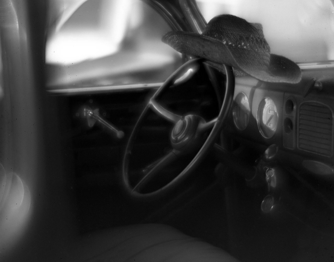

Lots of advice so far. Consider that an old Speed Graphic, the Anniversary model, has a built in curtain shutter capable of up to 1/1000 second all the way down to 1/10th I believe. A good one will cost less than having one lens installed into a Copal shutter. The Anniversary Speed Graphic used a 4X4 inch wooden lens board that almost anyone can make in the garage or back yard. Once you're up to speed on how the old Speedy works you can buy any barrel lens that you can cobble onto a 4X4 inch board and go have fun seeing what all the different possibilities are. I've included some images I made with just such an outfit and the lens is even simpler than most of the barrel lenses. I took the front glass off of some old opera glasses, mounted it onto a 4X4 home made lens board and made the images, no aperture no nothing. The lens is an achromatic doublet and this particular one measured just about perfect for 4X5 at 203mm and the aperture wide open was f5.5. Last image was similar but the lens measured at 190mm.
Great results!

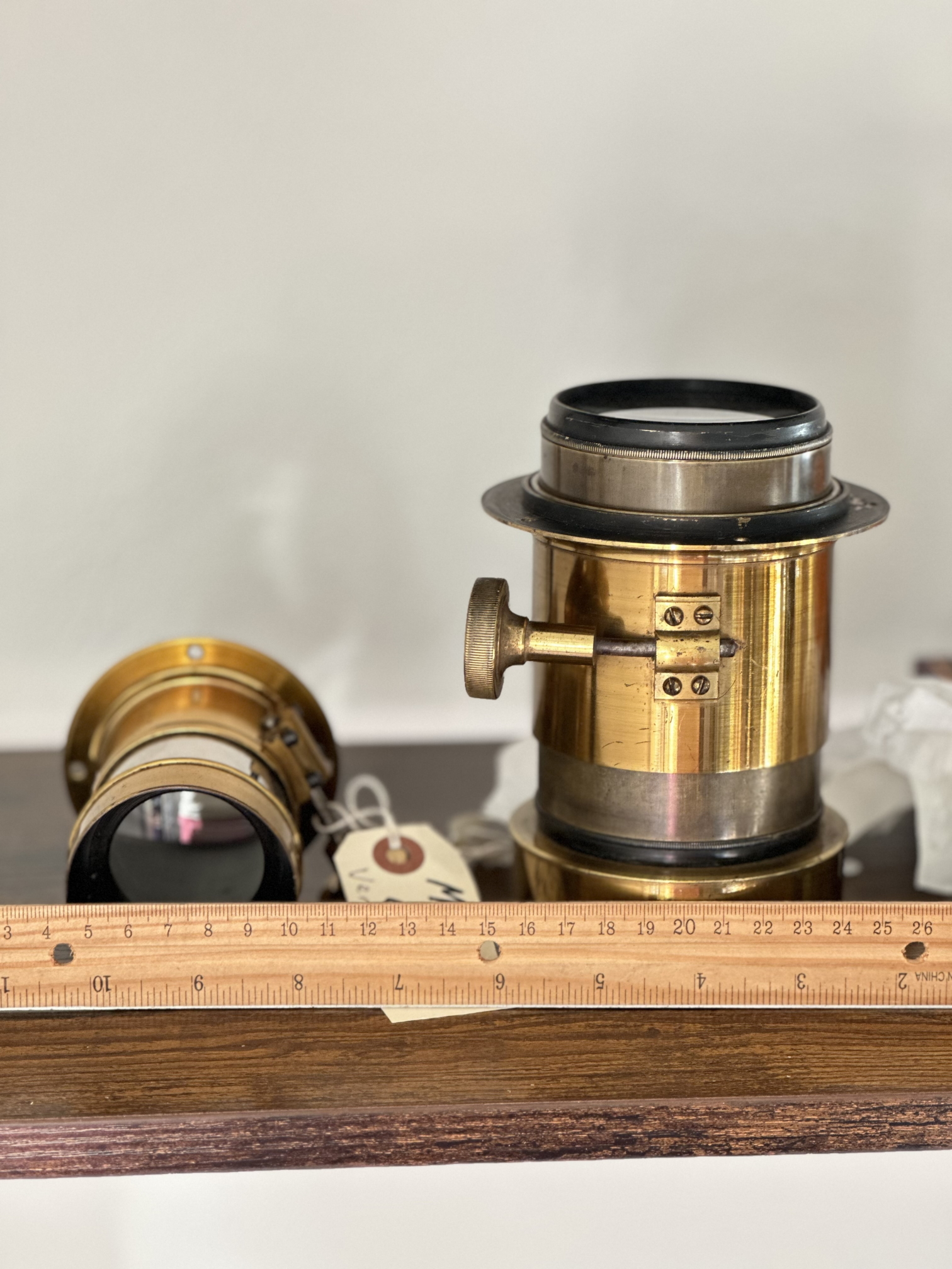

Thank you everyone for your advice, here and in other threads. I know more now than I did at the beginning of this process, and it would have been perhaps a bit cheaper and easier if I'd had that knowledge from the beginning, but hey! That's always how these things work.
I now am the proud owner of a 152mm Petzval, and a rather gigantic Petzval that the photographer selling it says offers a 220mm equivalent in about a 150mm nominal focus length. Hopefully, it will fit in the Compound #5 I ordered due after a user's extraordinary helpful tip about Igor's Camera Exchange.
The small lens has no apertures (yet); both of them, thankfully, came with flanges.
ame01999
Jul 28, 2009
66
I forgot the photo:
