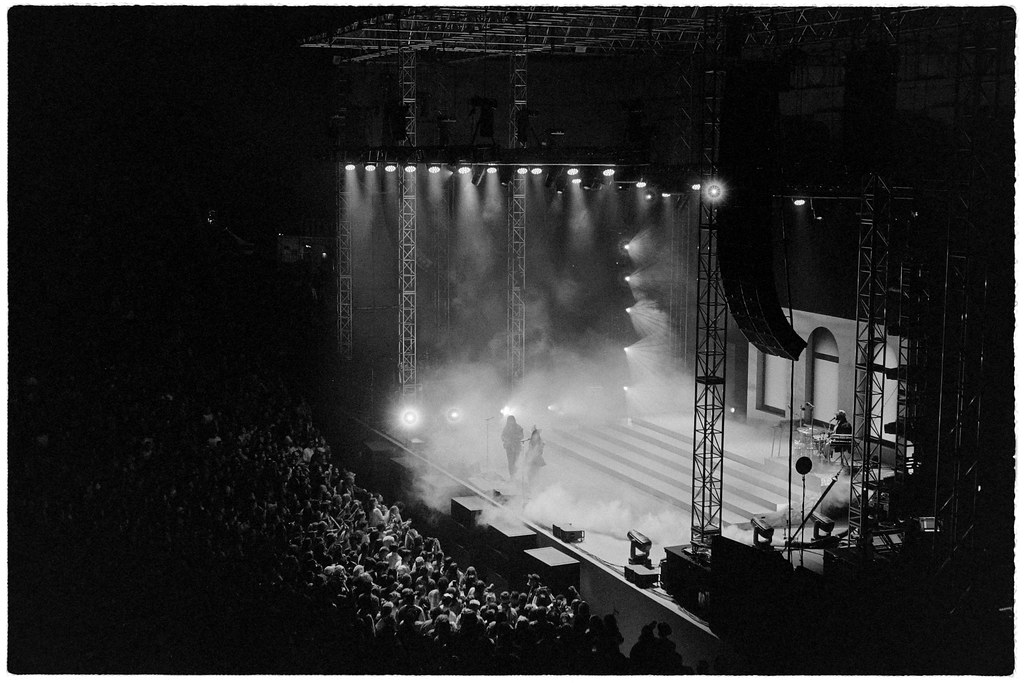

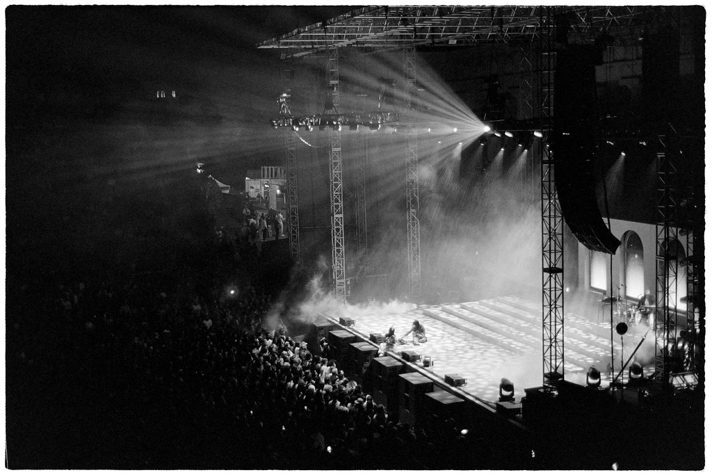

Another recommendation for Kentmere Pan 400, with some examples that might be similar to the OP's use case. Using a lens at or near wide open may contribute to more softness and "glow". I used the Nikkor-S Auto 55mm f/1.2 for these first two examples. In the second, you can see the halation around the ride cymbal.
by dourbalistar, on Flickr

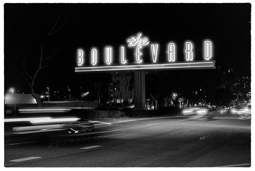

A few more examples that show Kentmere Pan 400's halation, in low-light settings with bright highlights. All of these made using an AI Nikkor 50mm f/1.8S, probably also at or near wide open.

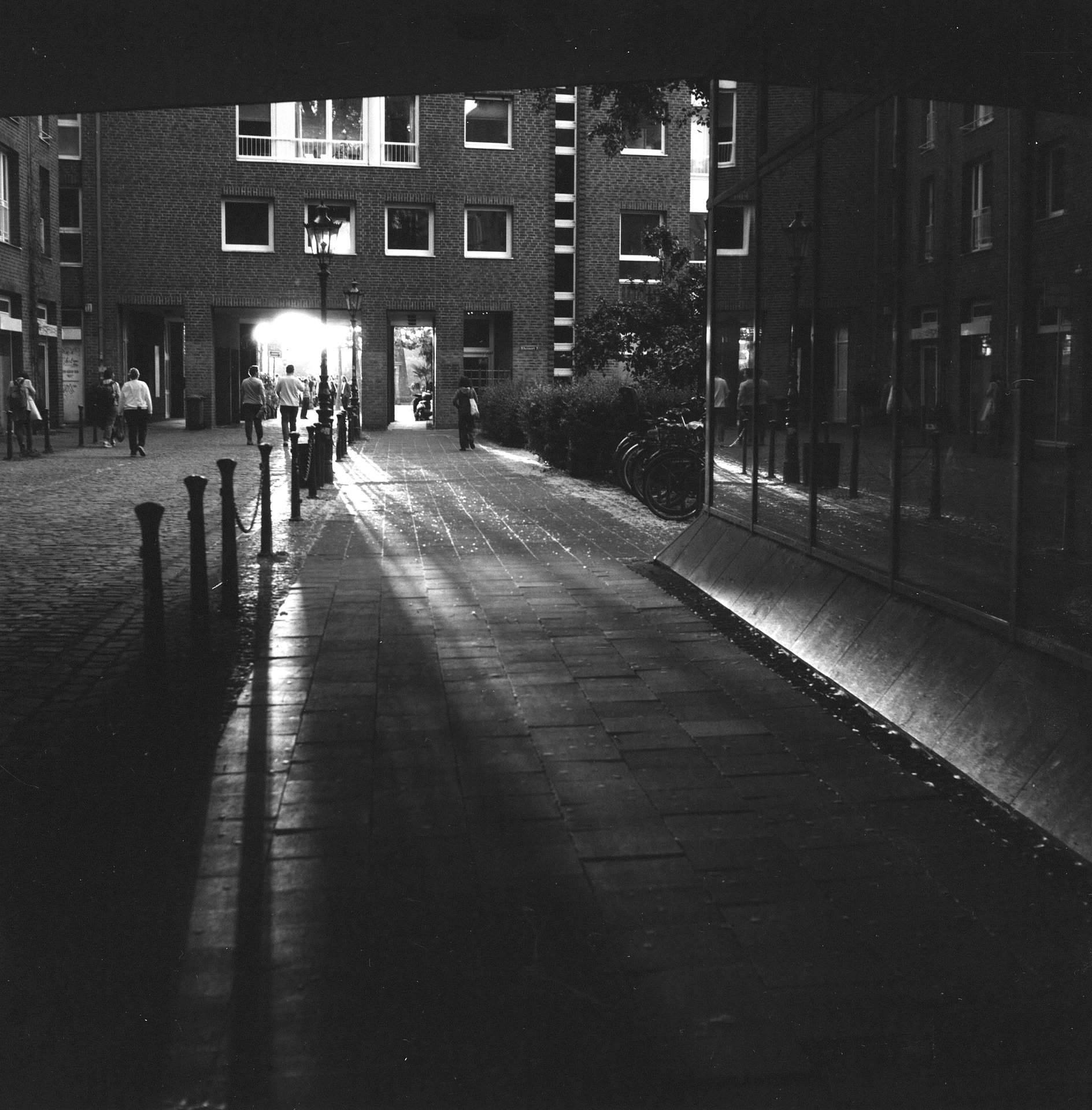

I just saw this frame from one of my contacts on Washi F.
Looks a bit like Kentmere 200-120.
Rolleicord V
Kentmere 200
Adox XT-3, 1+2
Silver Gelatine Print

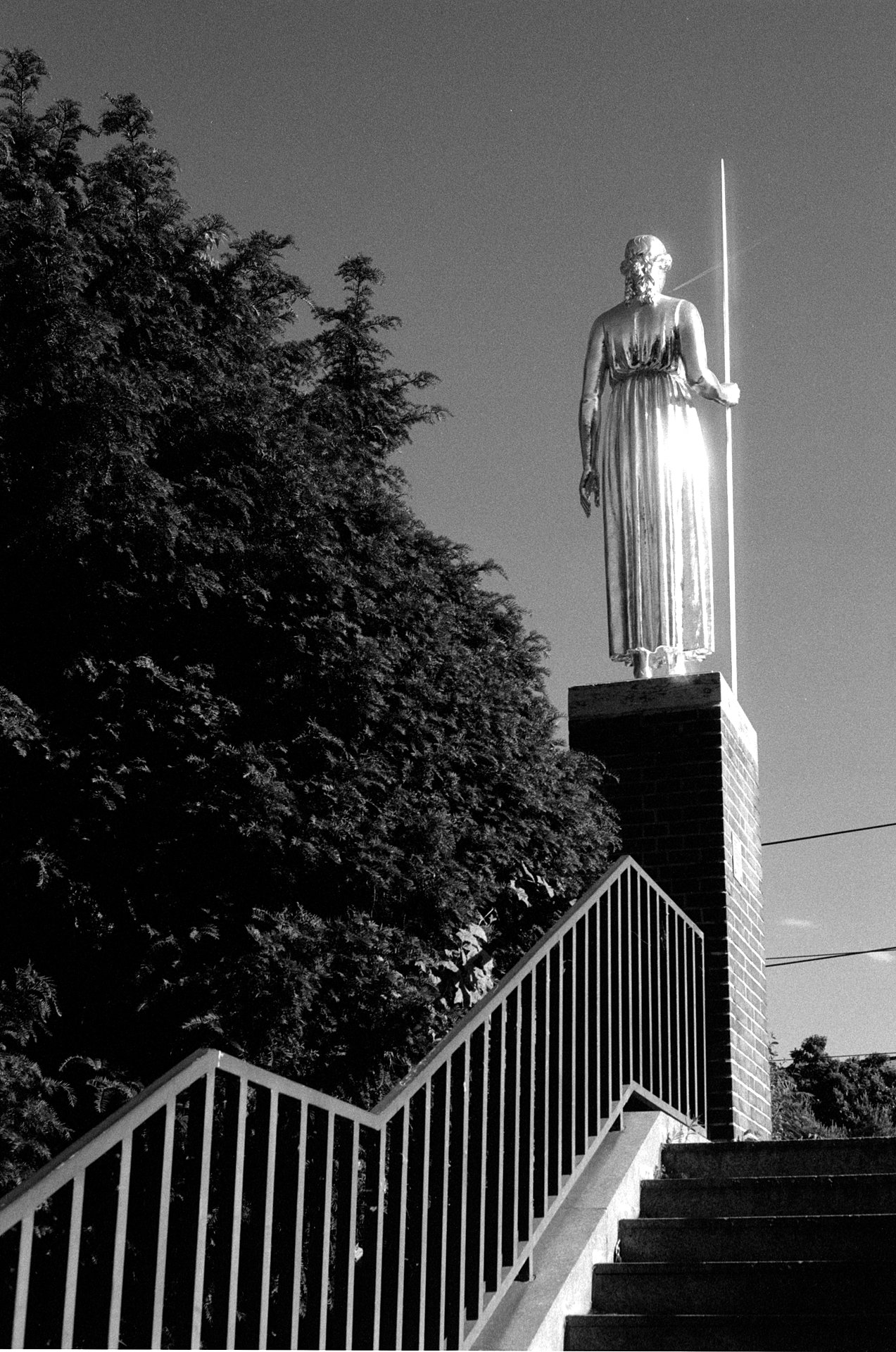

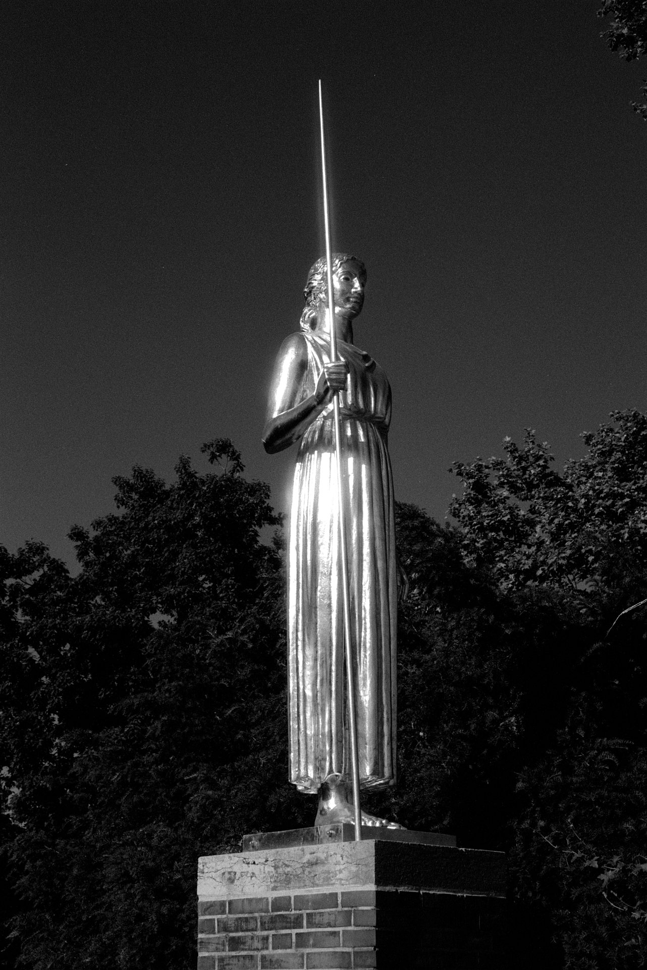

The C3 50mm was made as an uncoated and single coated lens, mine is coated but flares quite easily, even with a lens hood, shooting into the sun or even with strong lights it will flare, back to the sun, strong reflective surfaces, it will flare. With overcast sky, early in the day late in day, although a simple 3 element design, does quite well. At F3.5 not sure if it is fast enough or indoor low light. Maybe Kodak Double X pushed to 400.
Thinking about you have the C4 which has a 2.8 50mm, still single coated. With that lens I would use Kodak Double X, push to 400 and develop in Edwal 12. Photographers Formulary sells a version of it, if you can import it. Edwal 12 produces a glowey type negative. Not a compensation developer, used for shoot line drawing, what PF calls brilliant. Meter for highlights and let the shadows fall where they may.
