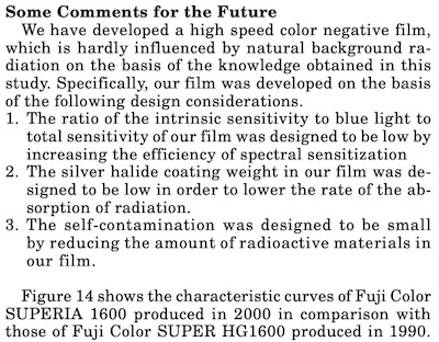

Did you read the paper I linked? It directly addresses your remark. Age-related fog can come from natural background radiation, of which cosmic radiation is only one part. The authors addressed the cosmic ray contribution by storing film in an underground low-radiation facility, in a box made of low-radiative-isotope-content lead. That had only somewhat less fog. According to the paper, what Fuji did to address fog was change the properties of the film emulsion, for example to offload more of the blue sensitivity into the sensitizing dye, and minimize the self-contamination by the emulsion ingredients. I attach here a paragraph from their conclusions. Those who want to see the characteristic curve figure 14 can read the paper linked above.
It is quite possible that Kodak took similar measures, I don't really know. This paper from Fuji authors is just what came up when searching for more information.
