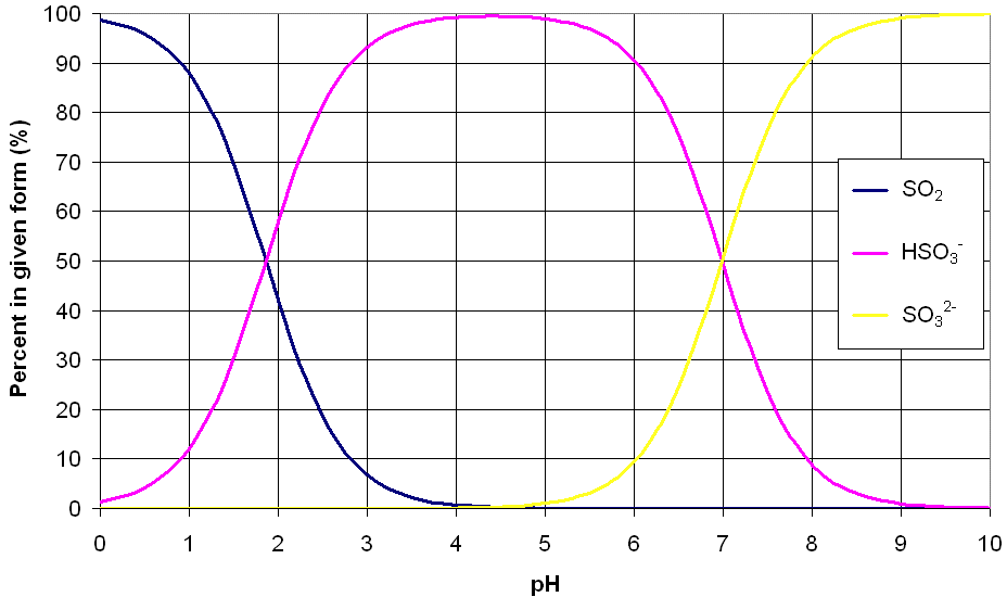

To add to the above - there's one particular reason why some may want to avoid too acidic a stop bath. It has nothing to do with the film, and it's actually not even very relevant when processing (small amounts of) film and more relevant to paper/print processing. When using a developer that contains a lot of sulfite (many/most print developers), a highly acidic stop bath (pH<4.0) will result in the release of some sulfur dioxide gas as a result of carryover of developer into the stop bath. The amounts involved are generally far too small to constitute any danger, even in a poorly ventilated darkroom. However, sulfur dioxide has a rather pungent smell easily irritates the mucous membranes, so many people find it uncomfortable. The cause is in the pH-dependent equilibrium of sulfite:
As you can see, this effect is virtually absent at pH>4.0, it's only very slight and may go unnoticed at 3.0<pH<4.0, but it tends to be quite noticeable at pH<3.0.
If this bothers you, you could consider using a buffered stop bath. See here: https://www.photrio.com/forum/threads/buffered-citric-acid-stop-bath.201215/
