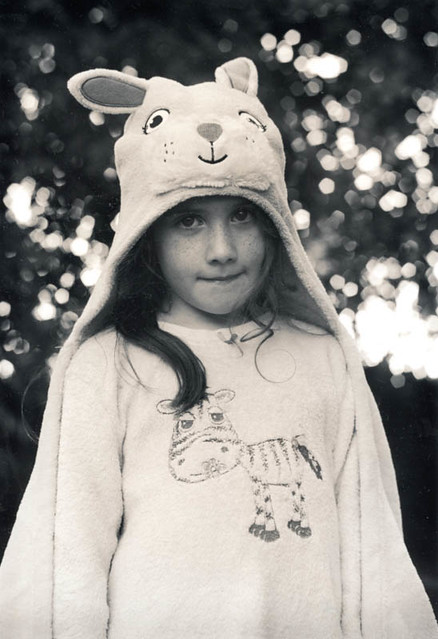

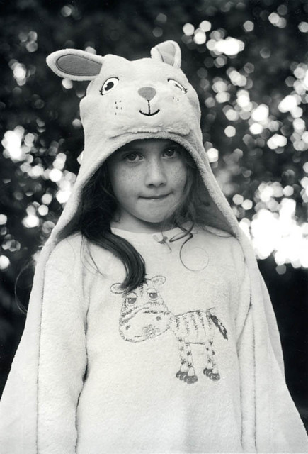

I use the Moersch MT3 sepia kit to try to get this tone. I bleach for 20secs (1/30) and then redevelop in the toner. Selenium toning afterwards will intensify the blacks a bit. You really need to have a control print and then a few for experimentation. Different effects depending on whether you selenium tone first or second and so on.
Anyway, these are just examples and its hard to see much difference onscreen. But the difference in the hand is much more obvious:
1st: straight print, no toning:
ros base print001-1.jpg by francis morrin, on Flickr
2nd print, this one selenium first, then sepia:
ros SE then sepia001-1.jpg by francis morrin, on Flickr
