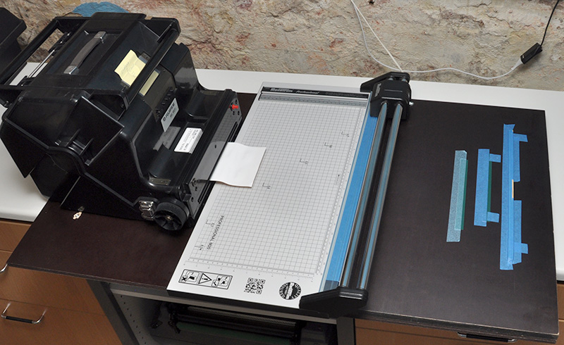

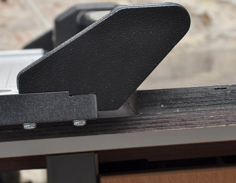

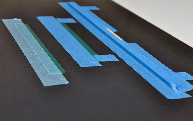

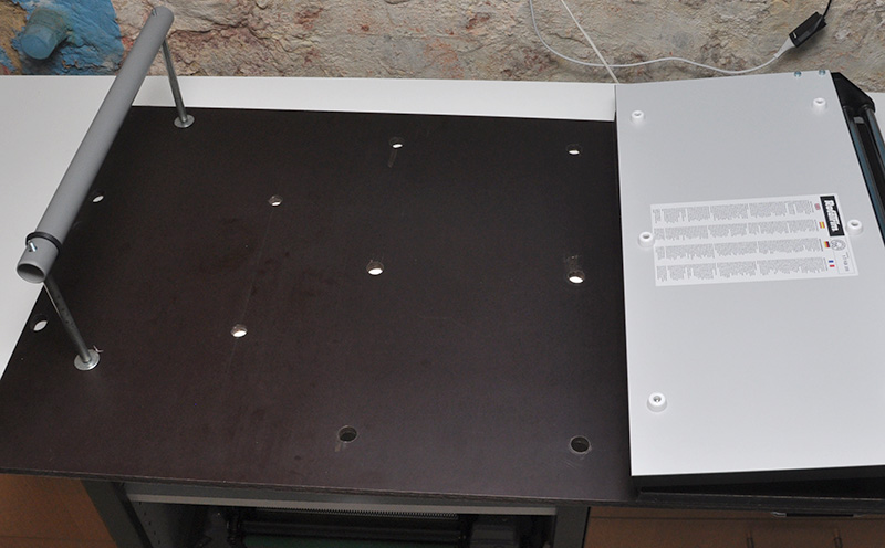

I also prefer Kodak paper.
First, I did try to cut it with just a Rotatrim but the sheets were not uniform enough to my liking. So I built a rig around the Rotatrim.
The paper is in a Fuji MG 180Y minilab magazine. This particular model is suitable because
a) it has a nice big knob for moving the paper both in and out,
b) the out-only limiter can be overridden with a syringe cap,
c) it keeps paper always aligned at 90 degrees.
The magazine sits at left with its feet in holes drilled into a thick plywood plate. Next to it is the Rotatrim, fixed parallel to the magazine. After that comes another piece of plywood for height compensation. The slightly raised length marks are taped onto that last plate and can be easily changed.
The magazine can hold any roll width up to 25 cm and they can be bought very cheap these days. I use a separate roll holder for wider rolls.
A very dim indirect colour paper safelight can help but is not really needed. The cutting speed is about 5 sheets per minute with some experience.

So you advance the paper through the cutter with the knob on the magazine ? Very clever . I have the identical cutter . How wide is your other magazine ? This looks very practical to me .
If the limiter stopping the inward movement is disabled, the knob allows to align the paper very precisely against the guide. Left hand turns the knob and right hand feels the paper's end at the guide.
Wider rolls do not go into a magazine, they just hang on a piece of plastic pipe (visible on the 2nd photo). This setup is good for up to 42 cm rolls, so standard formats up to 40x50 cm are possible. Another difference with an open roll is that it's aligned to the side, against the 90 degree guide on the cutter. This is not needed with the magazine.

Excellent , now I understand the pipe in the photo . I like how you have this set up . Now I have to decide whether I want to buy rolls, cut it and freeze it as especially the wider rolls would last me for years .
